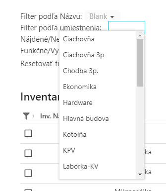

Hi
Someone found a solution?
Becouse i have also this problem. I have few filters and want them to reset with button.
Thx
Tomas
