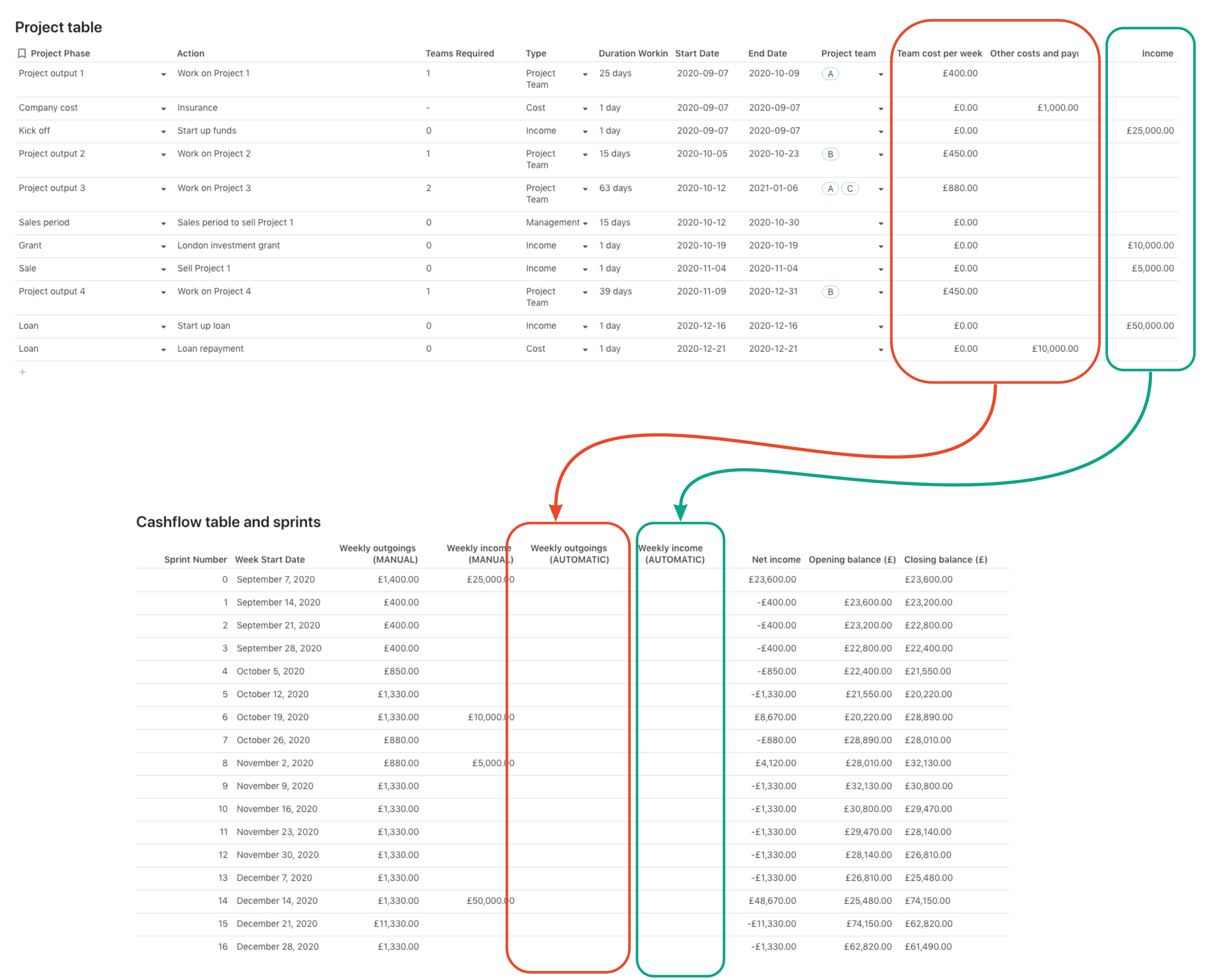

OK I think the next step is for you to create the table for the output you want to realize. What does a cash flow forecast mean in this use case?
Hi again @Johg_Ananda and thanks for persisting. I’ve reviewed the tables and updated columns and created formulas as appropriate.
The table Cashflow table and sprints is what I am looking as an output, where each week I will be able to get a net balance on my account, accounting for the various costs and incomes that week.
The Sprint outgoings and Sprint income columns have dummy figures but these should come from the Project table of the various team income and costs (Income less Team cost that week and Payments).

I have tidied up the tables and replaced the dummy figures in Cashflow with the actual figures I am expecting to see.
So in the Cashflow table I have manually input the Weekly outgoings and Weekly income in the columns with MANUAL in them. What I want though is a way to calculate this automatically. I’ve highlighted the values that need to go from the Project Table into the Cashflow table in the AUTOMATIC Weekly outings and income columns.

Okay I have solved it! It’s late but I will update tomorrow. Basically it involved Jean_Pierre’s solution of getting the date range for the project dates AND the dates in each sprint week.
This is what I needed to do.
In the Project planning table where I worked out how much a project phase would last, I had columns for Start date, Duration and End date. I created a column called Dates that got all the dates between the start and end:
Sequence(thisRow.[Start Date],thisRow.[End Date]).FormulaMap(CurrentValue.DateTimeTruncate("day")).Unique()
Then in the Cashflow table I created a new column to get all the dates that would occur in a week, ie not just the week start date but the next 6 days
Sequence(thisRow.[Week Start Date],thisRow.[Week Start Date]+6).FormulaMap(CurrentValue.DateTimeTruncate("day")).Unique()
From then I could run 2 formulae to gather the income and outgoings (Staff costs + other costs)
Income:
[Project table].Filter([Dates included].Contains(thisRow.[Dates included this week])).Income.Sum()
Outgoings:
([Project table].Filter([Dates included].Contains(thisRow.[Dates included this week])).[Team cost per week].Sum())+[Project table].Filter([Dates included].Contains(thisRow.[Dates included this week])).[Other costs and payments].Sum()
