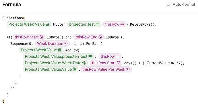

we create a button in your first table with this function inside
second, we have our target table as you see below
finally we set up a function that deals with the running total:
enjoy!
cheers, christiaan

Hi @Peter_Conijn , I spent a little time to craft a solution to this problem, as I see it quite regularly on other projects where reporting/summarising is needed.
The short answer, is that another table is needed to easily summarise the data in the way you want it. I created a Project Weekly Value table and added the necessary logic via a button column on the table. This allows for manual or automated updating of the summary table as needed.
I find using dates is better than week numbers for these types of reporting, so you can apply filters such as Future > Next 90 days to the table. To do this accurately, I normalised the project start and end dates. I added notes on the logic to the doc below.
See solution here:
