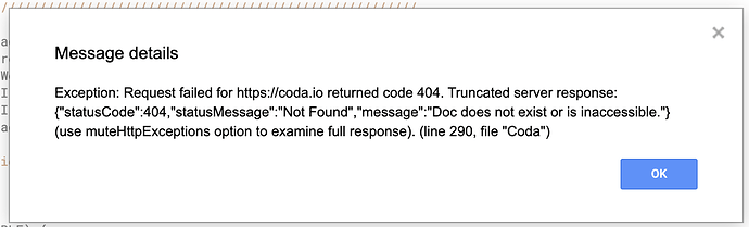

Or do I need to define the columns as well?
Hi @Thomas_Schulz, it looks like the TARGET_DOC_ID doesn’t look right. It should be everything after the _d in your doc URL. So try using vf5GA-qrla and see if it works.
perfect
thanks

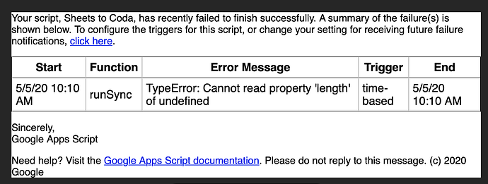

@Al_Chen_Coda one time sync now works, but adding the timer, I get this error message:
Any thoughts what it could be?
Are you able to share any screenshots of your Coda doc and Google Sheet? One caveat I mentioned in the blog post and video is that this shouldn’t be treated as a real-time sync. So if you are running the script every minute and making edits to Google Sheet at the same time, there may be issues due to the snapshot in Coda not finishing in time, Coda source URLs not copying over, etc.
Alternatively, you could try setting the REWRITE_CODA_TABLE variable in the script to true which may result in the script running more reliably but you won’t get the Coda source row URLs in the Google Sheet after the sync happens.
