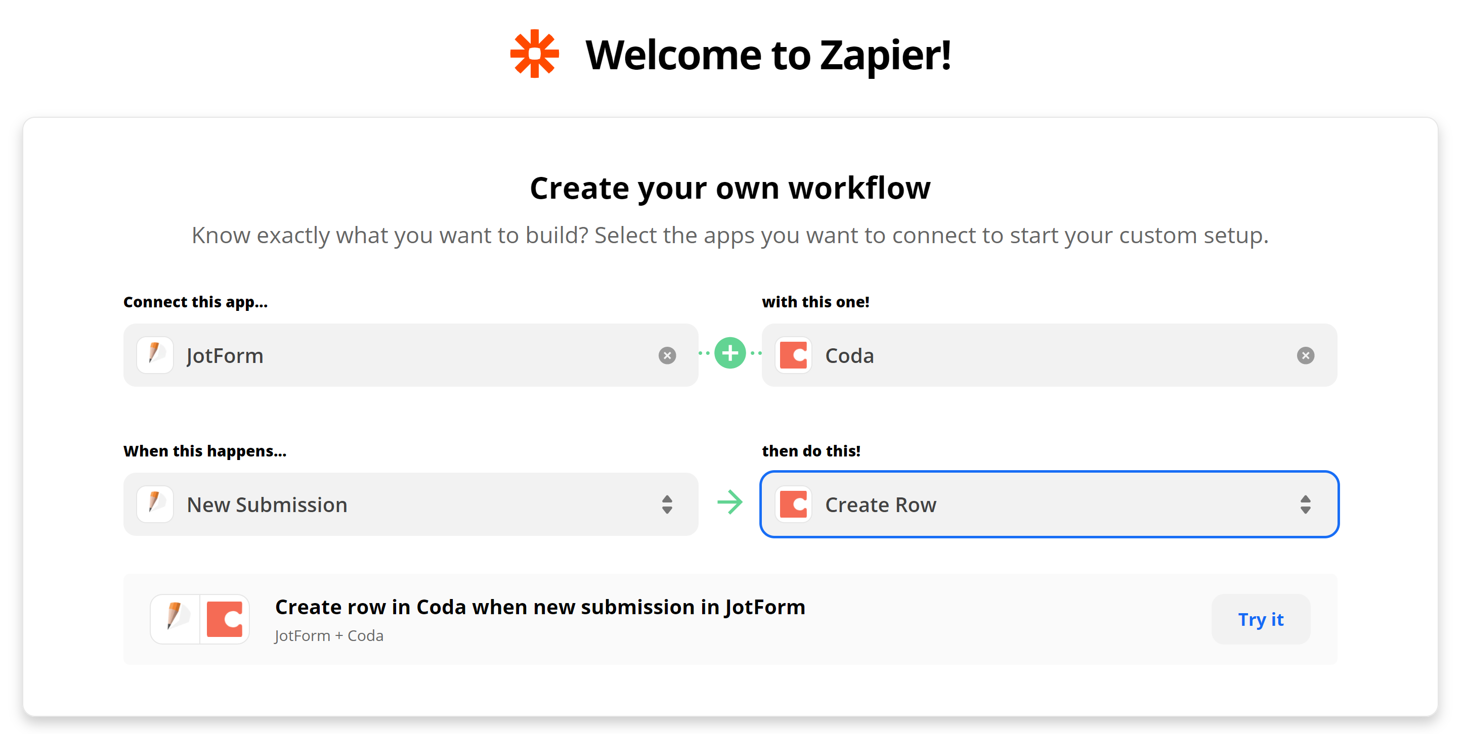

You can use either Zapier or Integromat to easily sync your jotform responses directly to Coda!

I don’t know JotForm and how they integrate with GSheets, what I do know is that via Zapier you can have the data directly in Coda and from there on everything is possible. It would require an intelligent set-up in Coda and I assume this is rather easy since something like that already exists in Sheets. The main difference is that you use one table for everything (instead each time a new table like you seem to do with sheets, each time a new tab). This one table holds all the data and from here you start.

Thank you! My trouble with inputting data directly into Coda from a form is that it adds extra complexity for my colleague. She makes a lot of these forms each week which is why I’m trying to keep this to familiar tools with all the advanced features we enjoy with JotForm. If this was just for me, I could work in Coda all day! ![:slight_smile: :slight_smile:](https://emoji.discourse-cdn.com/apple/slight_smile.png?v=10)
