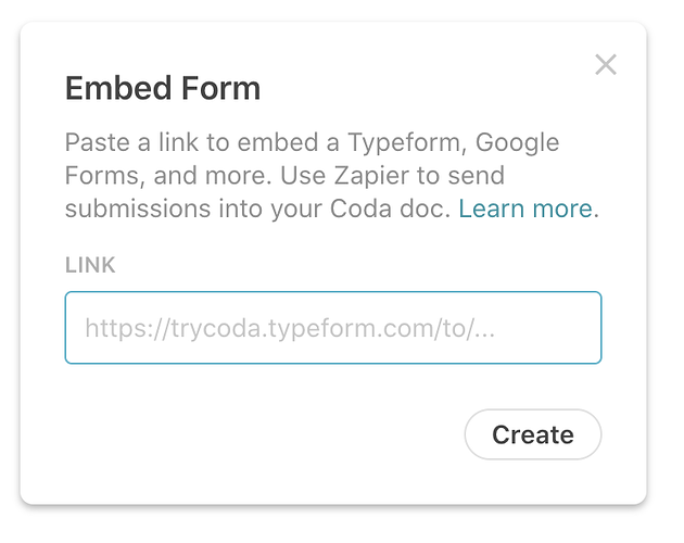

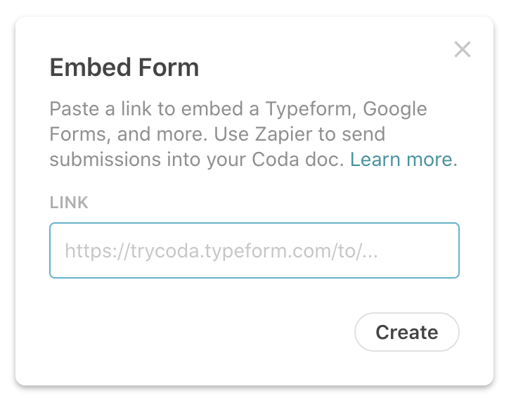

Would be great to include the google form directly in coda. Any plans for this @Krunal_Sheth
