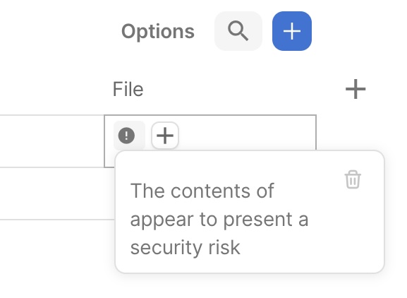

Can you provide an example of this? I am following this closely but am seeing Coda say “The contents of appear to present a security risk.”
Are there rules about the hosting platform on which the file exists? Thank you, any help is greatly appreciated.
I do believe that we restrict the upload of certain file types, like *.js. Have you tried uploading the same file manually? Putting the file in a zip should work around any restrictions.
I have tried the same file manually, and these files are just CSVs, XLSXs, or PNGs. Can you provide details on how Coda interacts with the publicly accessible URL?
I’m not super-familiar with the internal process, but at a high level we:
- Fetch the content at the URL.
- Send it to a security scanner to check for viruses, etc.
- Save the content into our CDN.
