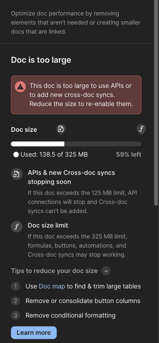

My main document also received this notification again, but in a new format. I duplicated the document and started experimenting by deleting a large number of rows, but I still couldn’t significantly reduce the document size or get rid of this notification. I really want to believe this is a bug
On the left is the original document; on the right is a duplicate of the same document, but as an experiment 13,558 rows were removed, along with views, controls, formulas, and buttons. This resulted in the document being reduced by only 3 MB, which makes me think that something isn’t right.
A doc we’ve used for years is suddenly flagged as too large—with no prior warning, despite Coda’s documentation stating we’d receive emails in advance. What’s more puzzling is that this isn’t even close to our largest doc in terms of table or row count, yet the other docs seem fine (for now).
The “APIs & new Cross-doc syncs stopping soon” message is both menacing and vague. According to Coda, the doc has already exceeded 125 MB, but the API is still working—so are we just supposed to live in fear of it stopping any day now? We have critical business processes that depend on syncing data from this doc via the API.

The limits have not changed, but the notifications have changed indeed.
At 125MB the API’s are supposed to stop working (my doc is a little over that size and they still work, but they will stop at some point).
Stored files do not count towards the doc size.
This was the answer from support:
Thanks so much for reaching out, and I’m sorry for any confusion this may have caused. I want to reassure you that our doc functionality and size limits haven’t changed. What has changed is that we recently introduced clearer, more explicit in-product warnings to better communicate existing in-doc limits, including the API doc size limit, which is stricter than the overall Doc size limit. These updates are designed to make limits easier to understand upfront and help prevent unexpected interruptions. You can find more details on our doc size limits here: Overview: Doc Limits.
Thanks for raising this, Chris. And thanks to everyone who’s shared similar experiences. We’re sorry for the confusion and frustration these new doc size and Cross-doc warnings have caused, and I want to clarify what’s going on.
To be clear up front: nothing has functionally changed in terms of enforcement. These limits have been in place for some time, and we haven’t made them stricter or introduced any new enforcement.
What has changed is visibility. We introduced earlier warnings based on feedback from makers who encountered limits unexpectedly, often without notice, and only realized they were close to the limit after something stopped working. Our goal was to help you remediate proactively rather than be surprised.
