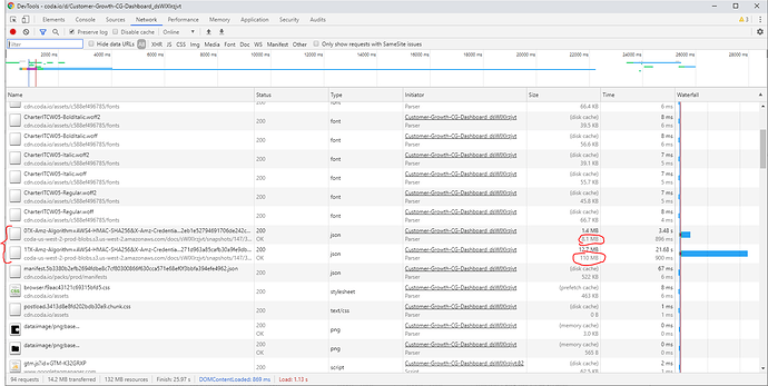

The doc size limit is 125 megabytes. This is 0.json (schema file) and 1.json (data file) size combined in their uncompressed form:

To those coming after, it seems these file names have recently changed:
0.json → ss-schema
1.json → ss-data
Edit: and in Chrome you may need to hover on the file size to see the uncompressed size
