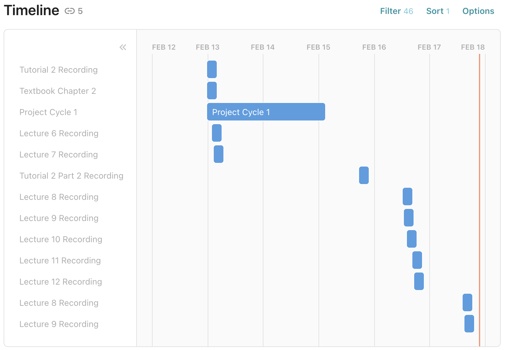

This allows for some powerful task tracking, like a Timeline view showing when tasks were started and created, and a Daily Overview of how many tasks were created today, how many were started, completed, were due today, etc. (examples at the end of the post).

Here are some examples of what can be achieved with this system:
