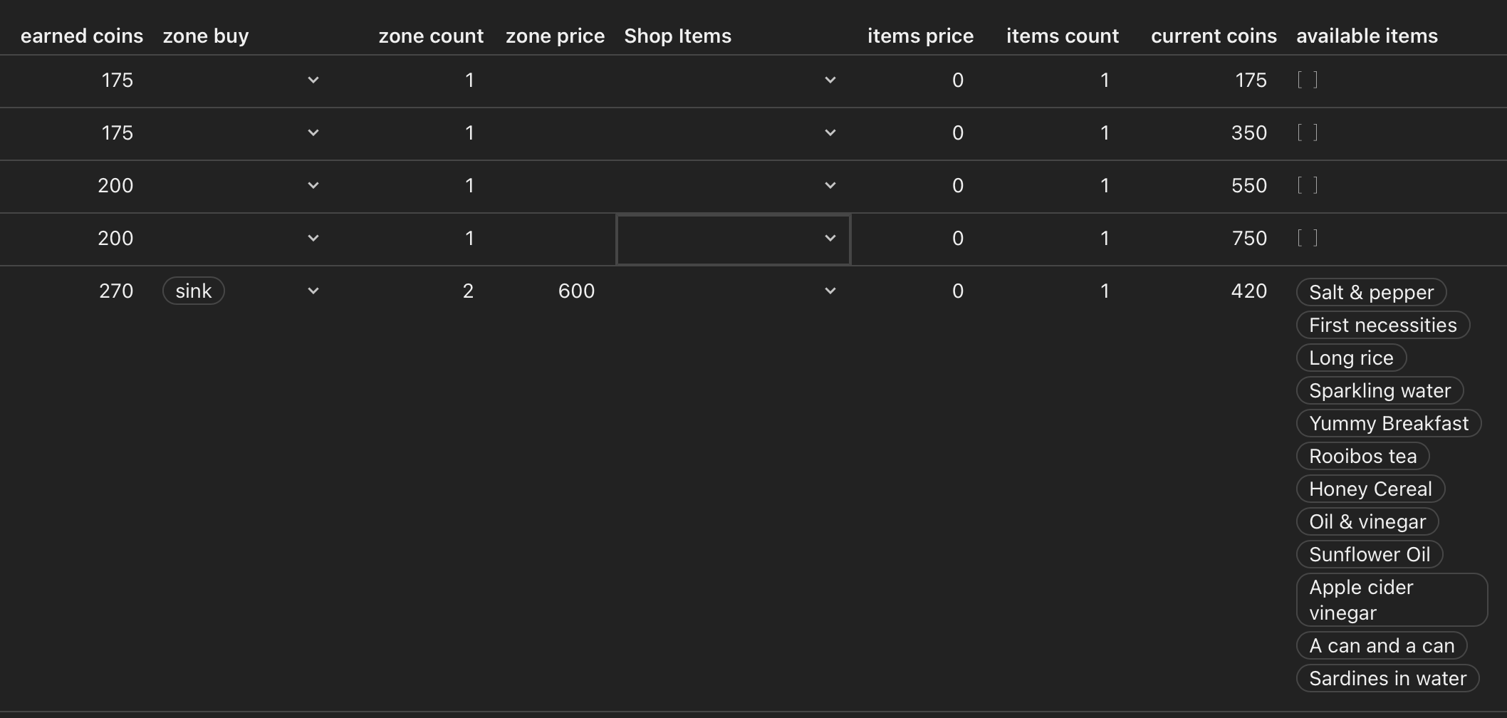

just to make it more clear maybe here is a screenshot of a part of this big table (also connected to all the other tables describing the game entities)
each line is the player playing one level. You can see the amount of coins they earn during the level. The current coins column is increasing until the player buys one new zone (this is done manually for now)
On the right there are the items from the shop the player can buy because they are unlocked (based on XP). This list has new items added each time they are unlocked. Oh, and of course each item has a different price :slight_smile:
What I wanted is to pick items from this column and display them in a new column so I can simulate the player trying to buy everything with the coins still in their pocket.
In the example here the player has actually enough to buy 4 or 5 of these items, so the other one would be bought on the next level…
I was thinking some kind of formula map that gets each item and add in a list and breaks (Is there a way to break a loop as in a for each statement?) whenever the sum of the prices would be higher than the current coins :sweat_smile:
