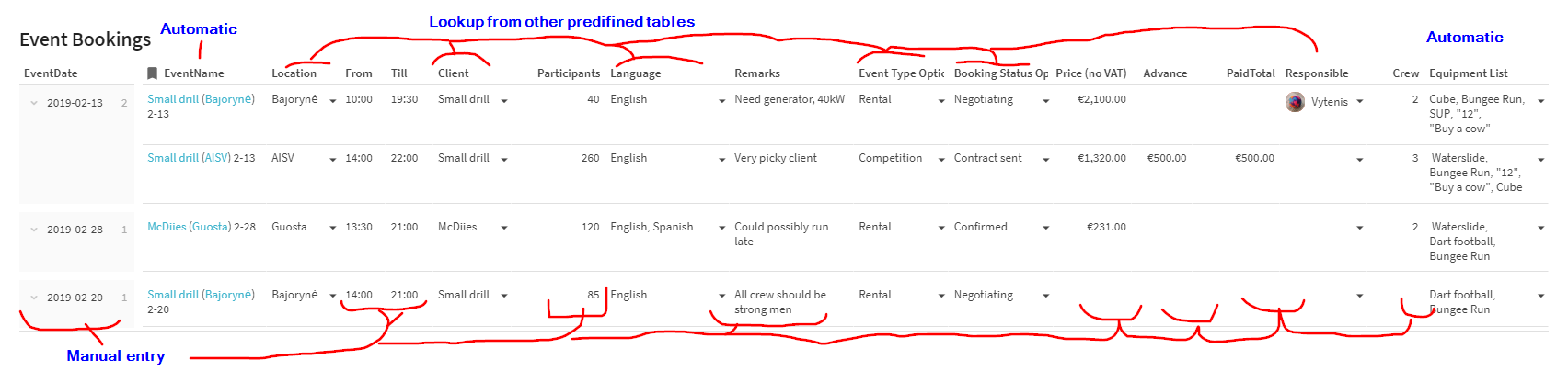

In Coda this table looks like this. Please note my remarks, for easier understanding where info comes by hand, where it is fed from other tables:
What is not seen - some columns that belong to Client (Representative, Phone number) are hidden. They can quickly be looked up by hovering on the Client entry.
The most complex here is the Equipment List Column. It should be filled automatically from Equipment Bookings Table (see Step 2 below).
