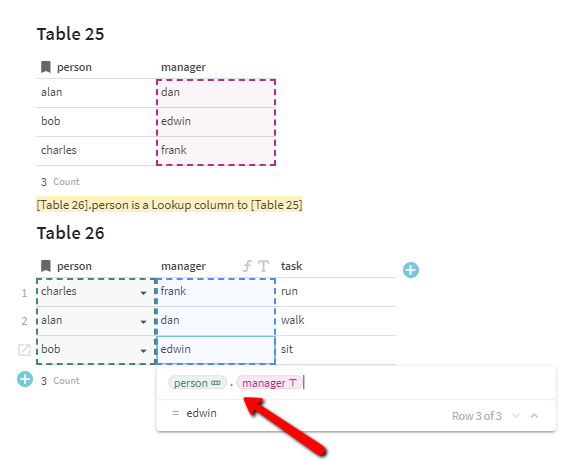

A View is a version of its source table. If you want something in a View, it must exist in its source table.
Here’s how you access columns in a Lookup table:
relational_table_2019-03-01_1523
Have you tried using Person.Manager ( where Person is a lookup column) ?
Thanks. I don’t know what changed (ie user error) but I tried again and now on the table when I click plus, it has the table1->Person as an option and when I click data it does exactly what I want – a column that shows the manager and is not editable. Works for both table or view. When I go edit that column, it shows it as a select list with the format of thisRow.Person.[Manager] – just as @mallika suggested.
It is working great now. Thanks!
