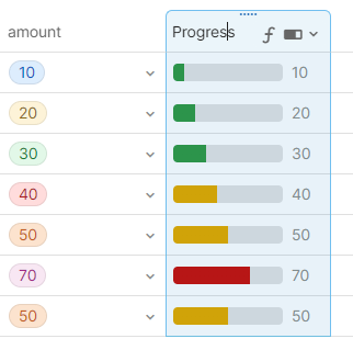

Hello @Rickard_Abraham ,
There are two ways of doing that.
- use a progress column and add your formula to that column. In the sample below the formula in progress is a very simple = amount (don’t type the “=”).

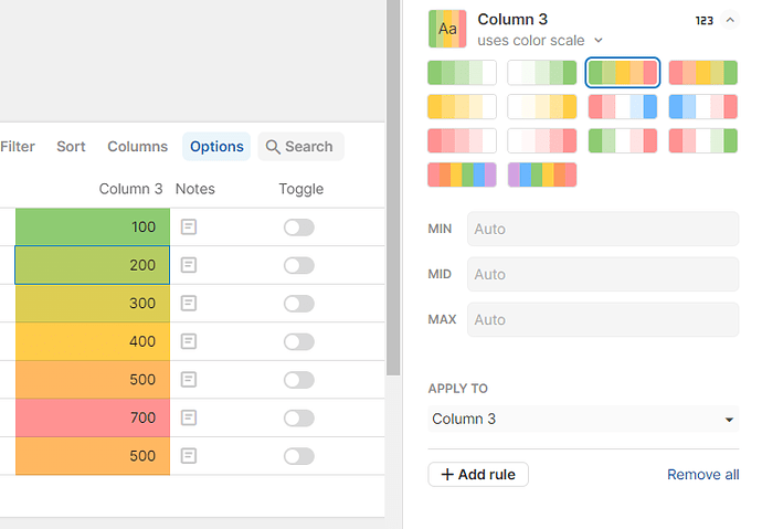

The other solution is to right click on the column with the formula and add a conditional format. Your column has to be a numeric type column for color scape options:
Greetings, Joost
