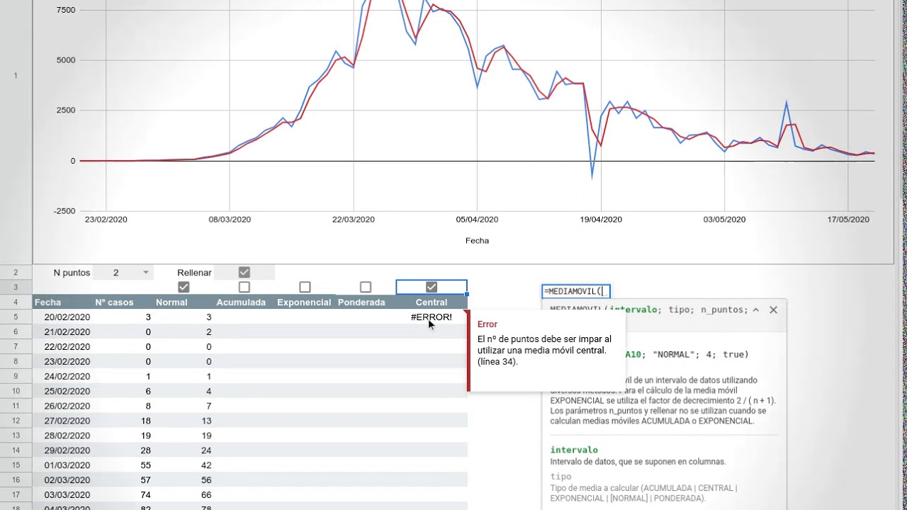

I’ve never implemented a sync table, but I understand that they are typically used to display cohesive data from, for instance, an external service. This is not my case, I just need to show a calculated column next to its source data column, as shown in this demo video:
Well, I will design my custom formula in the codan way and calculate one value (row) at a time.
