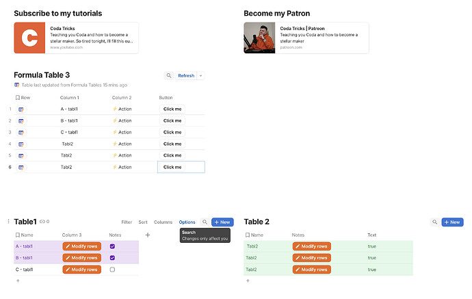

After playing around some, I was able to pull in the “buttons” from the individual tables (at the least the action) and create a main button column in the formula table that referenced the Action of each row. When clicked on in the formula table, I was able to update the individual tables (wish I could upload the video).
Basically, each button in the formula table can be customized instead of all one formula. I can see a way to create and manage a master button table. Pretty cool.
