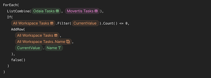

Im currently working on a project where we cross doc client workspaces into our main doc. All tables share the same columns.
I now want to create a master table that has a copy of all the tasks inside it so we can quickly see whats overdue, which task has a deadline coming up…etc
I tried this formula which runs:

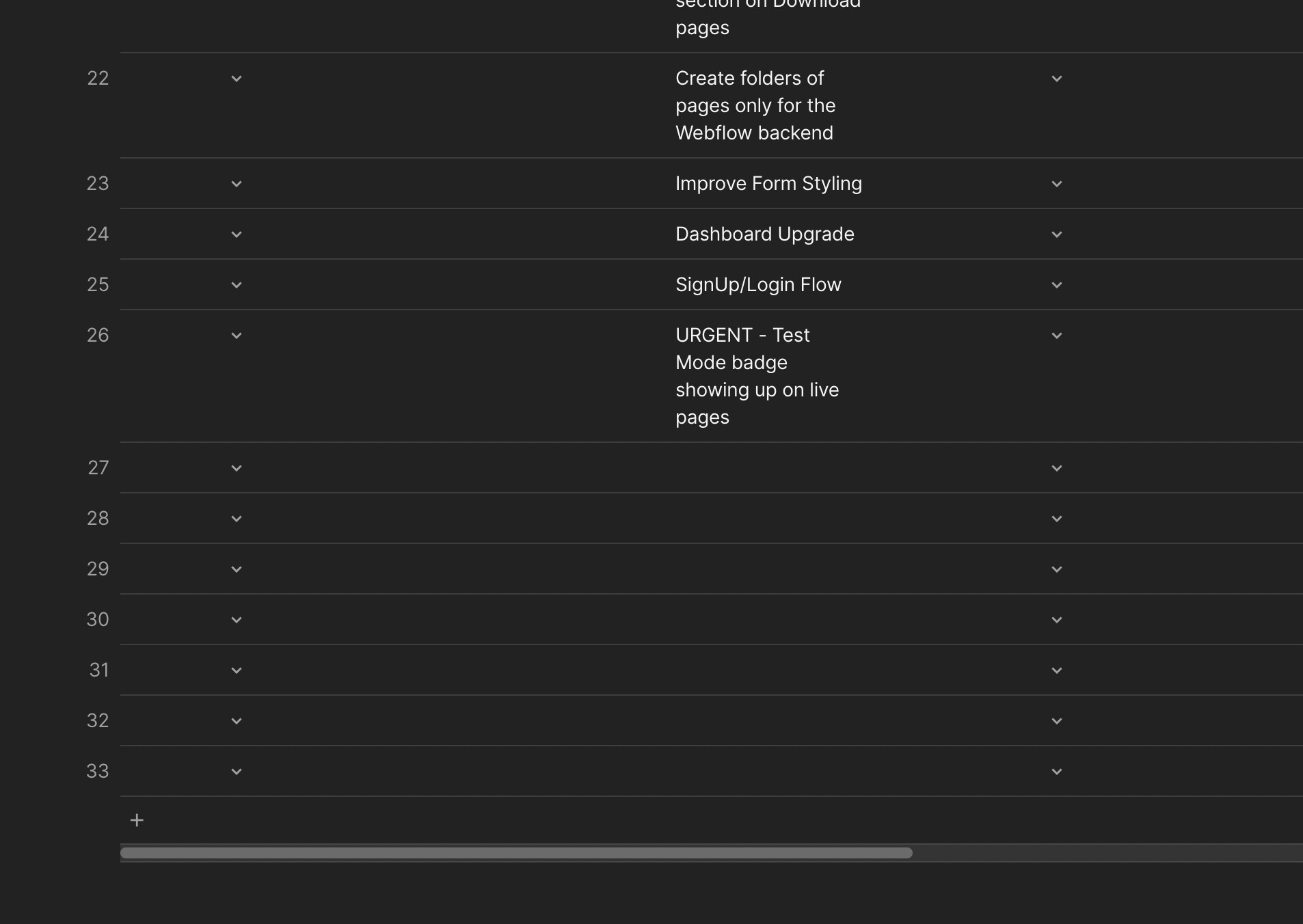

However when I run the formula it works for the first lists load of tasks but the second list seems to have its data missing and outputs empty row data:
What am I doing wrong?
Hello @Harry_Roper!
The problem is that for Coda those are 2 different tables, even if they have the same column names. So when you try to get CurrentValue.Name Coda can only reference the first table but not the second. That’s why you only get empty values when it starts importing the second table.
For this to work you’d have to write the same formula referencing each table separately, that means removing the list combine and use only one table on each formula, as follows:
ForEach(
  [Odaia Tasks],
  AddRow(
    [All Workspace Tasks],
    [All Workspace Tasks].Name,
    CurrentValue.Name
ForEach(
  [Movertis Tasks],
  AddRow(
    CurrentValue.Name
Let me know if this helps or if you have other questions. I’m happy to help
