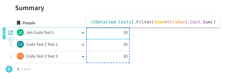

This issue is somewhat related to what @nigel posted about in this thread. I am confused sometimes as to why thisRow works vs. the column name when referencing column names in formulas. In this table below, I have a summary table at the top that sums up all the costs by person, and the table below shows all the individual costs:
The formula makes sense to me since you are comparing Name from the Detailed Costs table with the People column in the Summary table. Both People and Name are of the People column format.
If I change the formula to use thisRow instead of the column name, the formula doesn’t work anymore. I feel like it should, any ideas why?

thisRow returns you a reference to the current row value. It’s mainly uses when you want to compare whether another column contains a reference to the current row. You can also use it to pick another column from the current row - ex: thisRow.column. From your example, are the columns People and Name of type People? i.e. a reference to the document’s people table? If that’s the case then your Summary table formula for Costs should be:
[Detailed Costs].Filter(Name = thisRow.People).Cost.Sum()
i.e. using thisRow.People vs. thisRow. The reason is that the values stored in [Detailed Costs].Name are @refs to the People table, not references to the Summary table.
Nigel.
@nigel Yes both People and Name are the People type. In this example, since the Display Column on the Summary table is set to the People column, should thisRow return the People column automatically (i.e. you wouldn’t have to reference the column as thisRow.People)?
@Al_Chen, the display column sets the display value of the row but does not affect the underlying type of the row reference value. Think of it a bit like an envelope tuple with values (tableId, rowId, displayValue).
In your example, since the displayValue is a people reference, a typical Summary row’s thisRow value would be something like:
(tableId = summaryTable, rowId = xyz, displayValue = @Al_Chen)
So if you take a formula such as [Detailed Costs].Filter(Name = thisRow).Cost.Sum() it’s going to be comparing Name = thisRow which translates to:
@Al_Chen === (tableId = summaryTable, rowId = xyz, displayValue = @Al_Chen)
→ #fail
which will never match. If on the other hand you use thisRow.People you’ll be comparing:
@Al_Chen === (tableId = summaryTable, rowId = xyz, displayValue = @Al_Chen)-->People
→ @Al_Chen === @Al_Chen
→ success!
Nigel.
