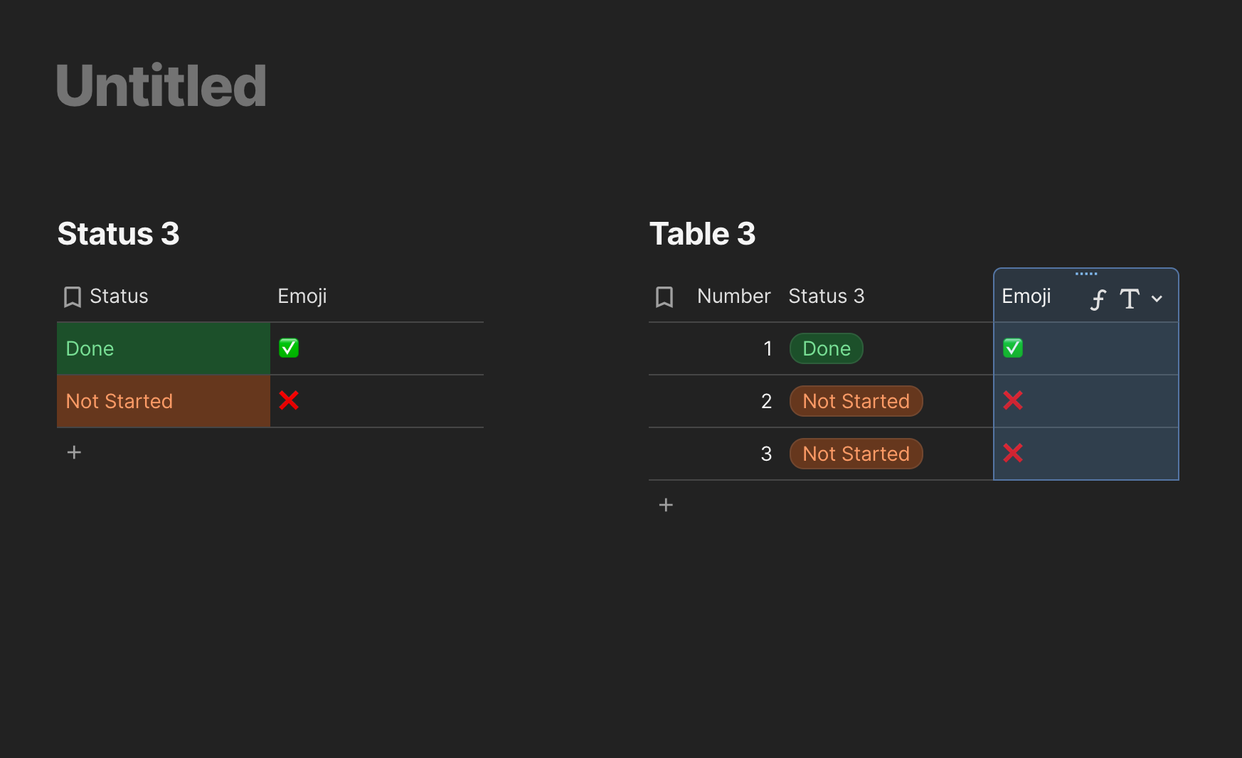

And just in case, here’s the quick simple I used for the screenshots (and Co.)
In the table [Table 2], you’ll find 2 lookup fields :
Status 2 returning the row Done
Status 3 returning the text value Done
So you can compare both formulas
