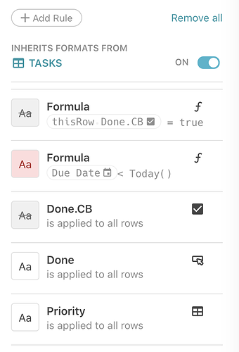

- The task table doesn’t inherit the master table’s conditional formatting. For example, the master table and all other views on a page (or subpage) shows strikethrough for all columns when a task is done. But the embedded table doesn’t.

IN that case the formatting behavior is as expected. Each view should have its own formatting, so that you can have views that are different. Otherwise a separate view would not make sense.

You are right about conditional formatting! I found there’s an option that allowed formatting inheritance in an expanded table entry view. I believe by default this option is ON if a ‘view’ is created on a page or a subpage, but default to ‘OFF’ when a ‘view’ is embedded as part of a table entry.
