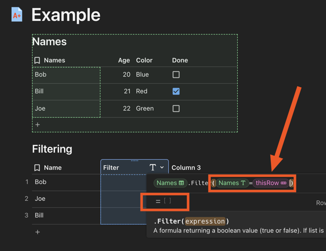

Notice that this here returns a blank value. Its not finding any matches. That is due to the fact that you are comparing two different data types. The data types of text and row value
In order to compare data as = they need to be of the same type (number to number, text to text, row to row). This was the first issue we addressed.

The key to understanding this is in the row value type seen here
That value is unique in that inside of it is stored all the data from every column of that row. So you can take the Bob row and reference any of the data within the row using your dot operator
For example, I can find his age or color, or any other data in that column
