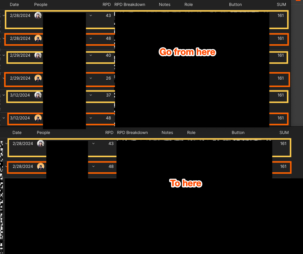

I’m currently using a formula to sum a number grouped by people—which works great!
The formula I can’t seem to figure out now in the table filter is to show unique rows based on a people column.
Context: I track the number of email replies our team sends in a table, per day. I’m filtering based on the last 7 days, and I would like to know the sum of replies sent in those 7 days, and only see one row per team member.
Right now, the sum is working, but I see the same team member multiple times (as many rows there are for the days replies were sent):
This likely needs something like: thisTable.Filter(People=thisRow.People).Unique() but this is incomplete/incorrect.

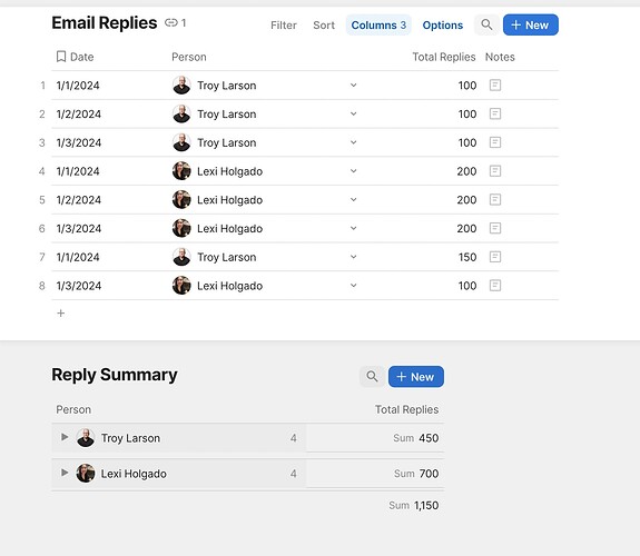

@Leo_Selie1 I put together a quick demo of what I think you’re trying to do.
Basically, I created a new view of the original table with a summary.
Let me know if you have any questions!
Hi @Troy_Larson —thanks for the assist, and sharing the demo!
This is indeed what I created earlier, but the problem is that I can’t sort on the sum. So, basically what I did is use a formula to create a sum, aggregating per “people”. This does work really well, however, I just need the unique rows based on the people, otherwise I can see the top-scorers in the table multiple times.
@Leo_Selie1 If you look at the demo again, I think this is what you are trying to do.
The top table is a list of email replies per day per person.
The bottom table is a view of that table. I just added a summary total on the total replies column, grouped by Person.
When you collapse the column, it gives you only one person per line, with their total replies.
