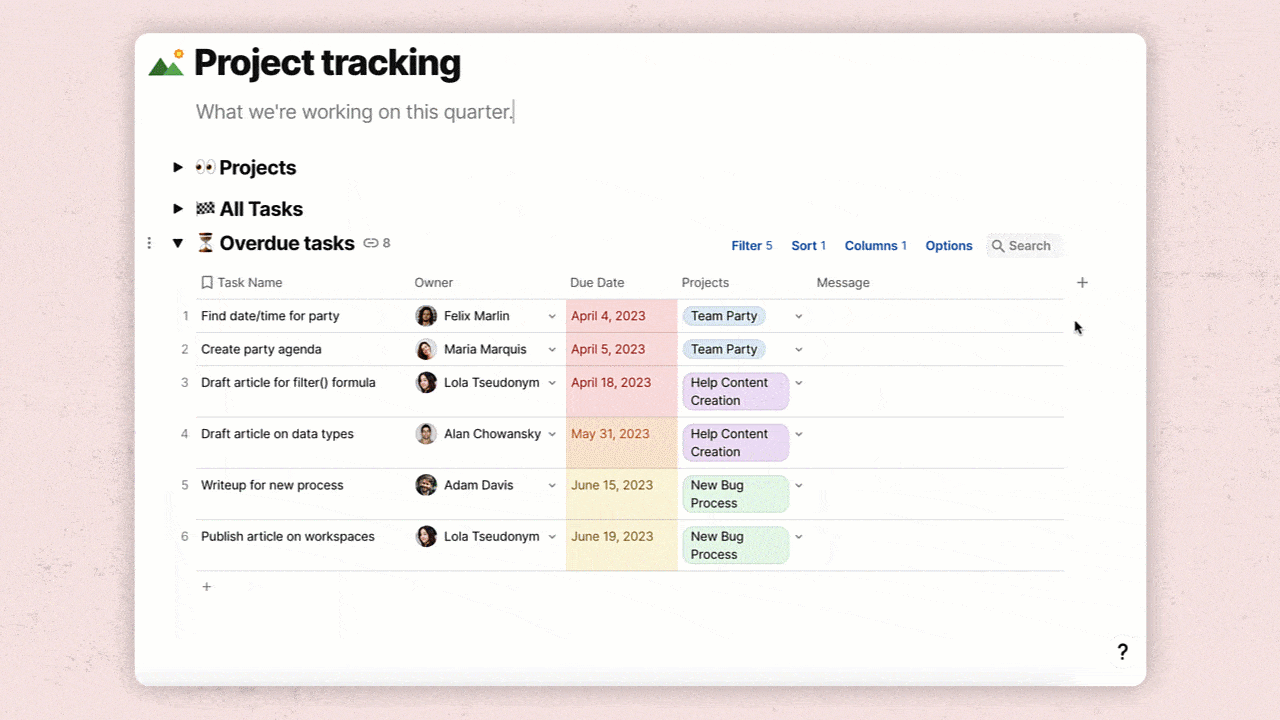

Hey everyone,
I’m a Product Manager at Coda and I wanted to let you know about the new Compose column type we just launched, which eliminates the need to use the Concatenate() and/or Format() formulas to compose dynamic text.
Compose gives you a freeform editor that lets you write and format text, including references to columns (using @) and formula results (using =). The resulting dynamic content can then be referenced by other columns.
Please give it a try and let us know if it helps address some of these types use cases.
Compose-min
