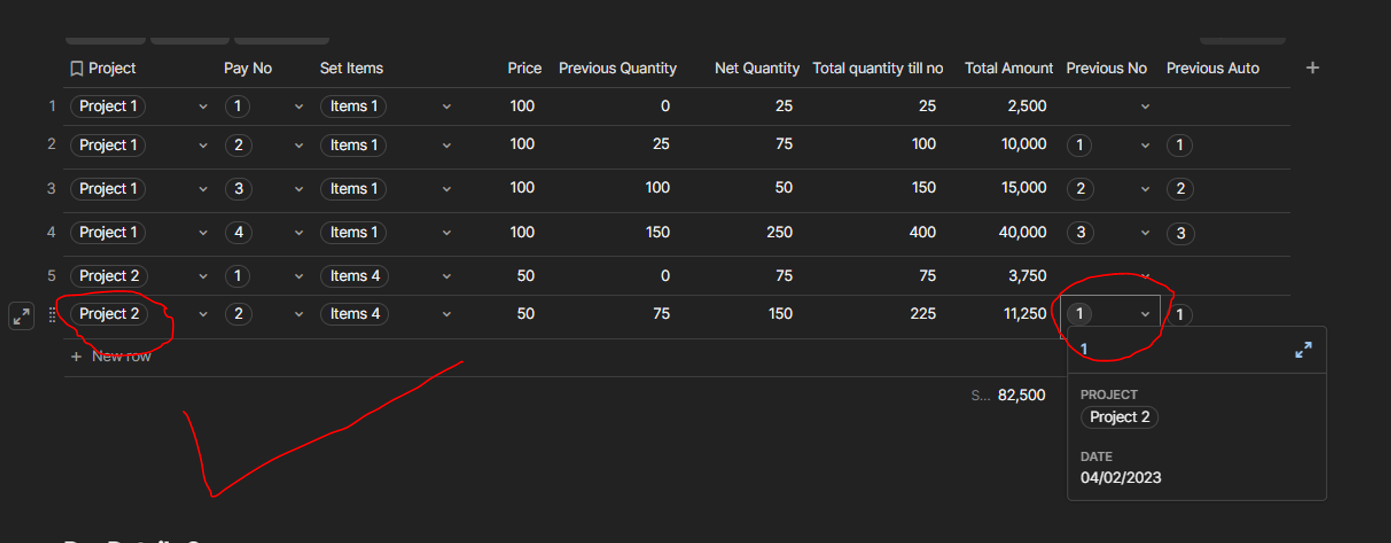

when i select Previous number manully i have option to add filter to the lookup value as shown
when iam using formula it populate this no and the option to add filter isnot available
and it generate number from another project as shown
can you help me to select Previous number for the same project in pay no table as shown
i trial to modify the formula not working as shown
