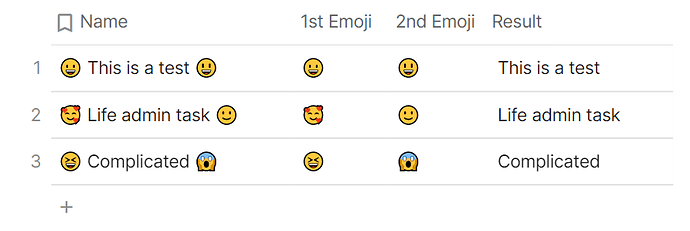

OK Sorry Guy.
This time I assume your configuration is EMOJI + Blank + string text + Blank + EMOJI
Formula
First Emoji > thisRow.Name.Split(" ").First()
Second Emoji > thisRow.Name.Split(" ").Last()
Result > RegexReplace(RegexReplace(thisRow.Name,thisRow.[1st Emoji],"" ),thisRow.[2nd Emoji],"")
