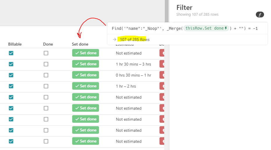

However, for answer completeness — yes, you can filter out the buttons that are disabled, i.e. whose action is internally set to _Noop(), with a formula like this:
Find('"name":"_Noop"', _Merge(thisRow.[My button]) + "") = -1
Warning: this is a discouraged approach. I only give it here for flexing illustration purposes and giving you an idea of the power of Coda.
