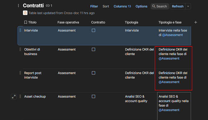

How can i filter row that have the same content in a table?
Hello everyone, i would like to know if, with filter, is possibile to filter row that have the same content, so that appear only one row
For exemple in my table i would like that if the content in the column “Tipologia e Fase” is the same, appear only one row and not 2 row like in the photo
Thanks a lot for your response

Thanks for the response
Here a copy of the document https://coda.io/d/Coda-community_ddaj2457igX/Coda-community_suJEY#_luCrS
I would like that in the column “Tipologia e Fase”, with a use of a filter in the table, don’t appear the duplicate value. So, for example, the “Definizione OKR nella fase di onboarding” appear one time and not 3.
I hope it’s clear and thanks for your response

Hi Math, thanks for your response.
I’m seeing but is not the same that i need.
What I mean if is possibile with filter, to hide duplicate values of the column “tipologia e fase”, so the final result (with the filter that we need to inser) will be this table https://coda.io/d/_ddaj2457igX/Coda-community_suJEY#_lu2OL
Thanks
In the example I’ve set 2 to display.
But you can easily set just one in the filter.
Then why report and not the other 2?
If you absolutely want to report if More one item, you’ll have to use a different method/organization or add specific filter.
Try this filter formula :slight_smile:
thisTable.Filter(thisRow.Tipologia e fase=CurrentValue.Tipologia e fase).First() = thisRow

Thank @Math_24 and @Rickard_Abraham for your help.
You tell me the solution and now it works
Thanks a lot and have a nice day!
