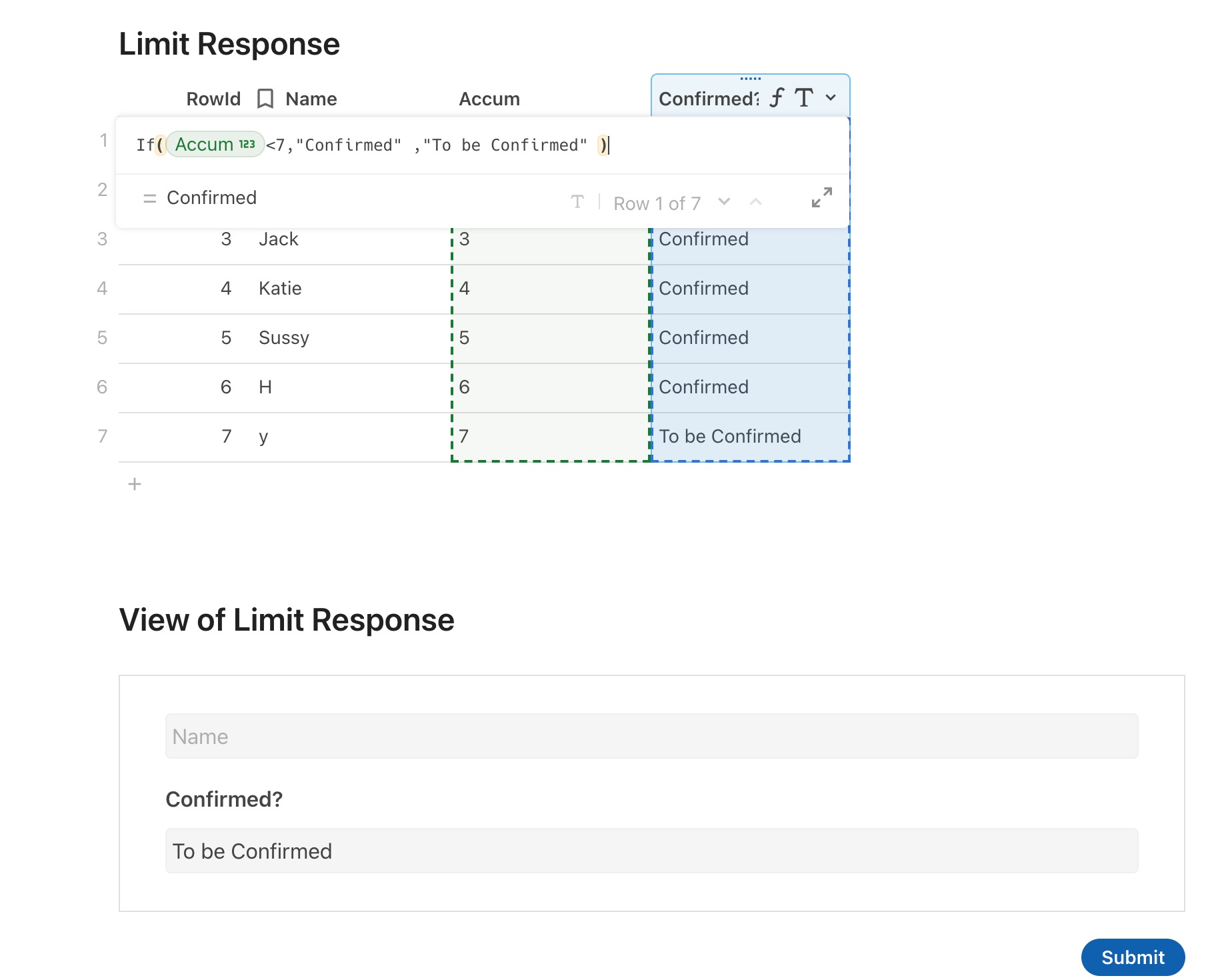

I like @Scott_Collier-Weir 's approach. You could also add a “accumulated” column just in case some gets more than one ticket.
It would look something like this:
You could then show the “Confirmed?” column in the form
Could this work for you?

Not really, but you could:
a) create an automation to send them an email after they submit the form.
b) use a formula to dynamically show “Confirmed” or “To be confirmed” directly in the form (like the image)
