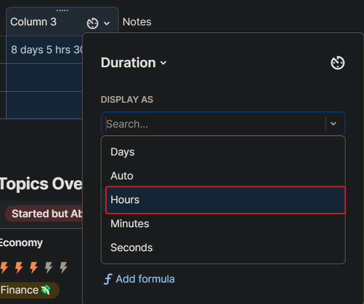

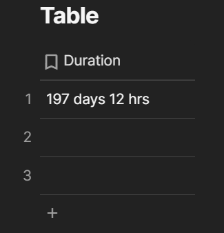

When I type in 197.5 inside a cell, I get this:
But I want it to show 197 Hours and 30 Minutes

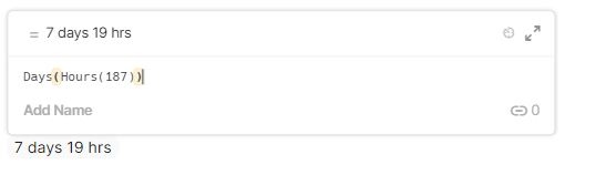

While at it…
Using regular formulas, how do I make it display the time in hours and not days?
So not 8 days 5 hrs 30 mins nut instead 197 hrs 30 mins
UPDATE
I found an answer to the original question, there is an option in display as hours…
I could swear that I tried that before asking the question and somehow didn’t notice the change…
But now I’m more interested in the second question regarding regular non-column formulas.
Hi Fran,
Try This
And this
It’s doesn’t get the desired result.
I want to display hours and minutes, not days.
Here is an example of what I want to achive:
As you can see, I can achive this inside column, but don’t know how to achive it on the canvas/page.
The big difference is that it calculates 0.5 hours to minutes, so instead of displaying 197.5 it’s 197 hrs 30 mins
There’s a hidden formula FormatDuration()
precision: 2 means use at max two numbers (e.g. hours and minutes but not seconds if there were any)
maxUnit:"hours" means the first number will be hours. Hence with precision:2 it’s hours-and-minutes and not days-and-hours.
