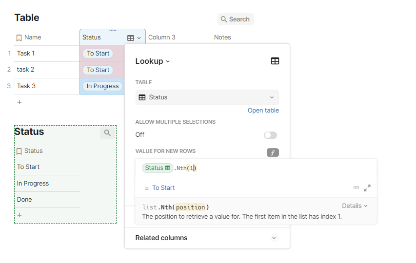

Let’s consider your table is as my example below :
You will set once your conditionnal formating in the column status like this
If you add a row every day with always the same starting status, I would suggest to use the functionnaly “value for new row” in the lookup options (my status is linked to a Status Table here)
Then, each time you create a task, the status will start being “To Start” in my example
CPT2211130031-952x948
Could that fit to your wish ?
Quentin
