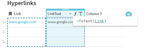

Not sure if you are looking to do this, but if you want to remove the hyperlink and convert to text, I put the following formula in a second column:
hyperlink

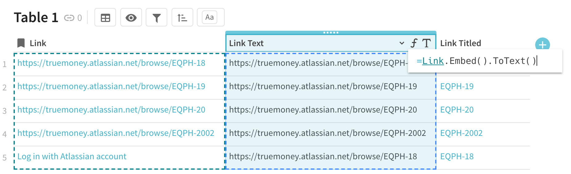

To get the hyperlink separate from the “Log in with Atlassian Account” title, you can use this in a new column:
Link.Embed().ToText()
You’ll see in the screenshot that I have full links and the link with the title, and this extracts the actual link text from both.

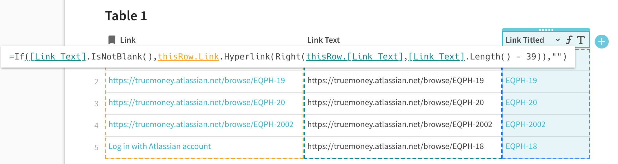

Then you can create a hyperlink with the ticket number as the title:
If([Link Text].IsNotBlank(),thisRow.[Link Text].Hyperlink(Right(thisRow.[Link Text],[Link Text].Length() - 39)),"")
I used an “If” statement so there isn’t an error if there is ever a row where there is no link, but if every row has a link, you can remove the “If”.
You can probably boil this down even more to get a full formula in only one extra column, but breaking it up in two helped me visualize each step a little better.
