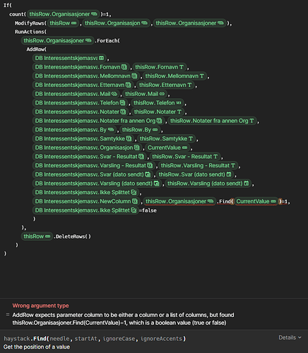

Hi Rickard
How would this find formula work exatly? I’ve seen some examples, and it looks like it can find for example text within something. Not sure if this accomplishes what I want. I can’t make your example work.
This is a different language for the columns and a bit more complex than the slimmed down example I gave, but it might give some better idea:
Even though if this might find the first item of the organizations, I don’t see how exactly I could set the checkmark column “NewColumn” to true with this.
Sorry if I’m missing obvious stuff here. Just starting to get the grasp of some of the simpler functions here. Coding is not my cup of tea :slight_smile:

Haha don’t worry I can read norrbagge :sweden: - It seems like you got the order a bit wrong, see what the error message says. The highlighted red error message is mentioning that the parameter “column” is wrong, it expects a column or list of columns, not a boolean.
Try swapping the position of our new formula line with the line above it :slight_smile:
Find works on anything that’s iterable, which text is also. It returns the index of the object (needle) inside the iterable (haystack). If it doesn’t exist then it returns -1
You are absolutely right, Rickard! That worked very well. I do not know exactly how, but as long as it does the right thing I’m happy. Hehe. I created a new column with checkmark and it works very well by marking one of the items as unique. That way I can run automations for sending mail just on the unique rows. Beautiful! Here’s the formula in case someone want to see later on:
It was my stupid mistake of entering the new line of code in the middle of an AddRow part. I’m tempted to pass partial blame to Coda for not having wider screen for editing the formulas, but I’ll take the responsibility of my stupid oversight yet again :slightly_smiling_face:
