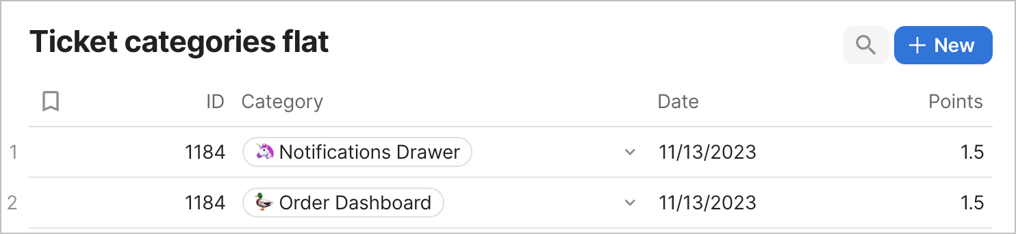

i have a table with work tickets. the columns are ID and Category
a work ticket can have multiple categories. my goal is to flatten this out into another table such that each work ticket ID has only one Category. So, if work ticket 123 has 2 Categories in the source table, it will be 2 separate rows in the target table, both with the same ID in the target table. then we can do some reporting on the target table
this is a sample of the source table:
and this is a sample of the destination table:

ForEach(
  Source.Filter(ID.In(Destination.ID).Not()),
  WithName(
    CurrentValue,
    parent,
    ForEach(
      parent.Category,
      AddRow(
        Destination,
        Destination.ID,
        parent.ID,
        Destination.Category,
        CurrentValue
Micah,
thank you SO MUCH :grin: :grinning: :grin: :grinning:
this is exactly what i was trying to do.
your solution is very clean and very elegant. all i did was replace the table and column names.
many thanks and happy new year to you
and thanks for putting together an example coda doc with the solution. that was super :pray:
