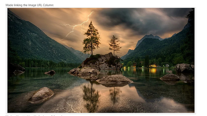

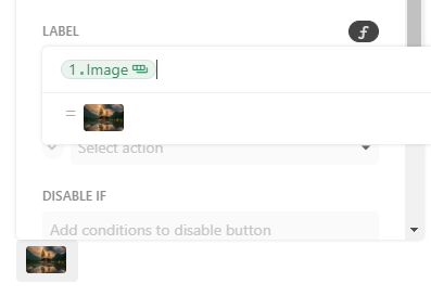

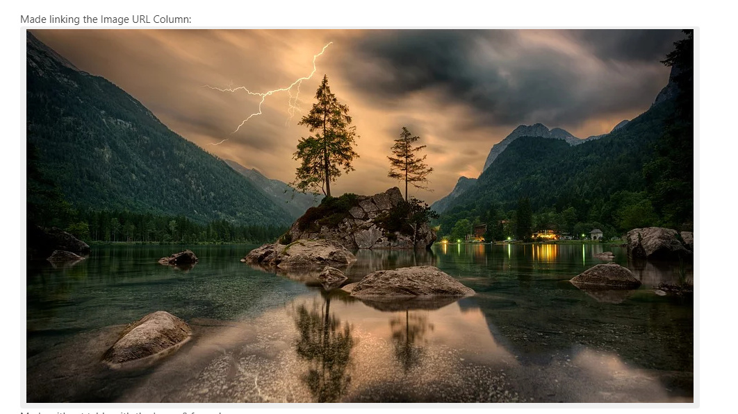

Another way is making an Image URL type column and linking the button label to that column, also, if you don’t want to make a table you can put the Image() formula in the label of the button with your image url and you get the same result.
A button as big as the size of the image you used, or if the image is bigger than the canvas, it is resized to the max width of the canvas.
The only problem with this is, as with the previous approach, that even if you change the parameters either from the column or inside the Image() formula, none of this makes any difference. You can’t resize the button.
