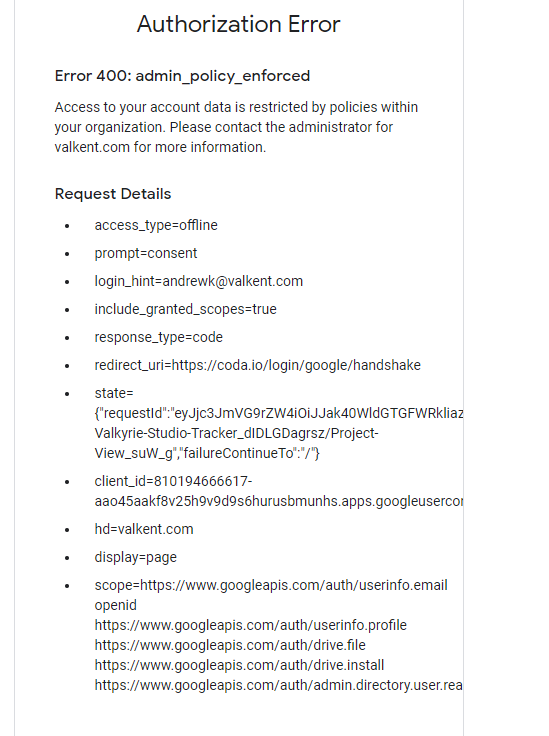

As of today all of our accounts for our studio domain valkent.com have been restricted from accessing Coda. I need help to restore access for our entire team. What do I need to do?
we are back… This is apparently a google problem. We had to reauthorize it via gsuite
To anyone else facing this issue - there appears to be a g suite rollout issue impacting multiple domains (not coda specific) . https://support.google.com/a/thread/18752577?hl=en

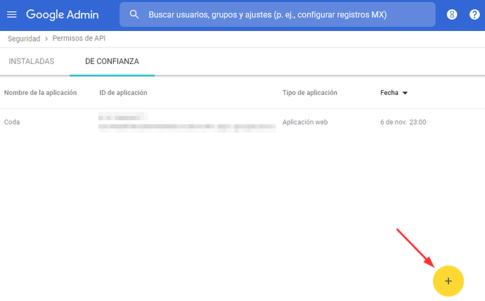

GSuite Admin > Security > API permissions > Search for Coda app ID (Oauth ID)
Security > API permissions > trusted applications > Add app to whitelist
If this does not work please contact support@coda.io.

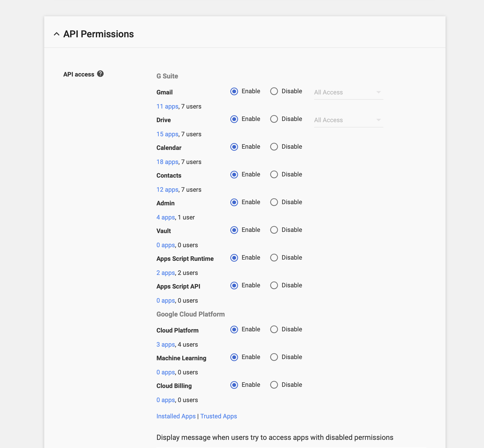

Update here - we are back! In the first area of the API permissions under Security, not all of these were enabled:
I enabled them all, logged back in. During login I was asked for my role - so for a moment I was nervous my account had been “cleared,” but once I answered that question, I found myself on the regular start page, so all good on this end.
Indeed I obtain this solution after 90 minutes of raw panic. I had to show some quite impressive Coda results to a prospective customer and ta-daaaaa… nobody in my GSuite Domain could access to Coda.
The key point is to force Coda API as a trusted one in GSuite Administration.
