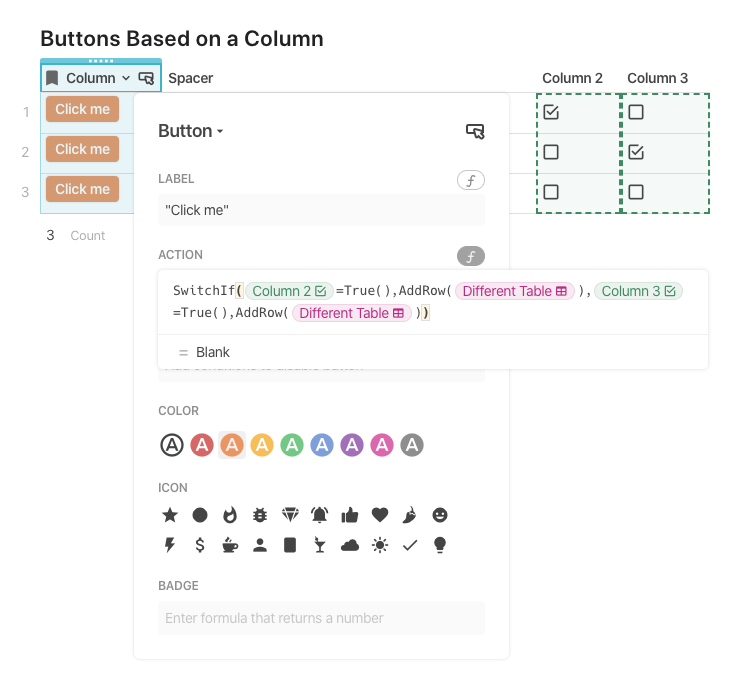

This seemed like an interesting request, kind of a brainteaser, so I wanted to give it a shot. Here’s what I came up with which might work for you depending on how many options/tables you need to create buttons for. The idea is to use the SwitchIf() formula and depending on the criteria, the button will add a row the appropriate table. If you have a lot of options to account for though, this formula might grow too large.
Here’s a screenshot of the settings though, just in case it helps…
The formula for the button actions is…
SwitchIf(thisRow.[Column 2]=True(),AddRow([Different Table]),thisRow.[Column 3]=True(),AddRow([Different Table]))
Curious if this is what your need, or at least close!

thanks. fair point. strangely, from a UI perspective, you can do different things if your buttons are in a column or a row, but this is probably the easiest solution.
@BenLee, Thanks! ooof, kinda a mess that we have to resort to this, but this does get it done for my needs. thanks for the idea! any idea if this comes with a big computational overhead, or does it get compiled or cached somehow and look like any other button?
I don’t think it would be much for processing overhead, but depending on what you need to base it on, the formula can grow pretty big.

Same as I was going to suggest — but Ben, why aren’t you formatting your formulas nicely?
What kind of example are you setting?
You can shorten the formula a little bit—since [column 2] and [column 3] are checkboxes they’re already TRUE or FALSE expression so you can Leave the =true() out and spare 7 characters for each table
SwitchIf(
thisRow.[Column 2],AddRow([Different Table]),
thisRow.[Column 3],AddRow([Different Table])
Hardly
SwitchIf(
[Add to Table 1], Table1.AddRow(...),
[Add to Table 2], Table2.AddRow(...)
P.S. Actually no; either replace checkboxes with a select (if only one table should be updated), or support ticking off multiple checkboxes at once:
RunActions(
If([Add to table 1], Table1.AddRow(...), _Noop()),
If([Add to table 2], Table2.AddRow(...), _Noop())
Otherwise the multiple checkboxes + logic to only add one row is counterintuitive. And this is actually a bigger issue than lack of pretty-printing.
