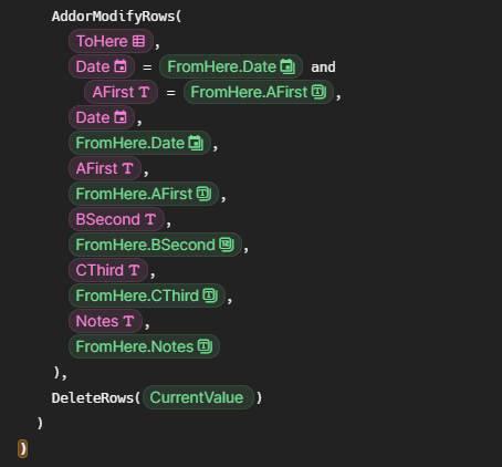

Apologies I know this has been covered before but I still can’t figure out where I’m going wrong. I’ve tried to model after Copy Row From Table to Table. I’d like to copy rows from one table to another all at once with a single button push. But each copied row is having multiple values per cell.
See here:

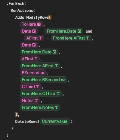

One key thing to keep in mind when using such short names for the columns is that Coda formula engine autosuggest might not find them when you cerate a formula. You should name them something longer then A, B or C when you are in the build phase.
Secondly you were copying a list of items and not individual rows as you instructed the AddOrModifyRows to equal a list (see 4th line in the screenshot)
See the difference
