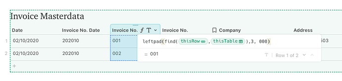

Here is my current doc (See the Invoice No. column in the Invoice Masterdata table:
You can have an automation reset the invoice number once a month. You have to set the automation everyday at 00:01 AM (maybe 00:00AM works too - you have to test). Then add a 2nd condition to make sure the current date is the first day of the month)
The other button is needed to make a new invoice - something has to trigger making a new invoice. Of course you can hide the column with the invoice number, less confusion there. Adding the month in the invoice number can be done with another helper column, with the value today() to extract the month number. Make sure you use two digits for the month (01, 02, …,11,12) to keep the invoices correctly ordered - it looks like you are now using one digit for the month,
I actually use your idea and added if(today-1=endofmonth(today,-1), 1, Invoice No. + 1) on the increment button to reset the sequence at the end of every month. It’s almost perfect. But I still have to find a way to reset if a new invoice is added on date after 1st automatically.
And yes I hide all the columns so it’s neat and simple.
For that reason I recommended to use an automation - because you can make it trigger the button just once at the very beginning of the month. Instead of triggering the button you can also use the automation to set the value back to 1.
Automations can be used to set values (change row) or to push a button. I am not sure of the button should be taken out of the table but that is easily found out.
