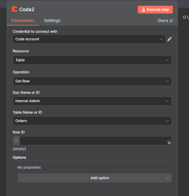

Hi I am using the Coda n8n node with “get row” operation.
The tool requires the RowID to function, however from all documentation I can find on this, including topics on this community, I am understanding that RowID is never exposed (Getting Actual Row ID Within Coda) so I am a little confused as to why an official Coda tool is asking for something which is “never exposed”.
How do I provide this tool the rowID it expects? I am guessing I am missing something very obvious. :sweat_smile:

Thanks Simon, the issue with searching for a row first (get many rows) is that
  1. there’s thousands of rows
  2. you need a different identifier, essentially faking rowID, to then find real rowID.
I found a hacky solution to this by creating a formula column with:
Split(thisRow + “”, “/”).Last()
This actually exposes the rowID inside a column which I can then send to n8n using a POST function. So much easier! As to why it needs to be this way I don’t know but it at least works.
