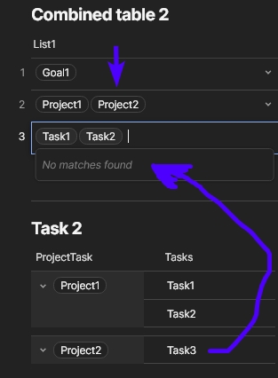

Hi!
How to make the elements “Task2, Task1, Task3” look exactly like “Project1, Project2” and “Goal1”, i.e. in a circle, as a reference:
Thank you very much!
Hi!
Hey there @11177 !
I think you can use that LC column to get rid of the circular reference. I also find it easy to use .in to compare value to list of values. See example in second screenshot below.
In case it’s helpful, here’s the link to the example doc: Q: Circular reference · Misc
Hi @paul_p !
Thank you so much for your reply!
There’s a problem.
If you select several projects, there should be tasks for all of them in the drop-down list .
Here’s more details:
The problem was solved here -
