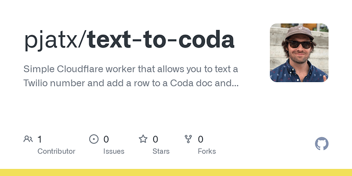

Hey There,
Often times, I want to add something to my todo list without having to pop Coda open and wait for it to load. I thought about this problem a bit and ended up writing a simple serverless function that listens to messages sent to a Twilio number and adds the content to a Coda doc / table.
Wanted to leave it here in case anyone else finds it useful!
