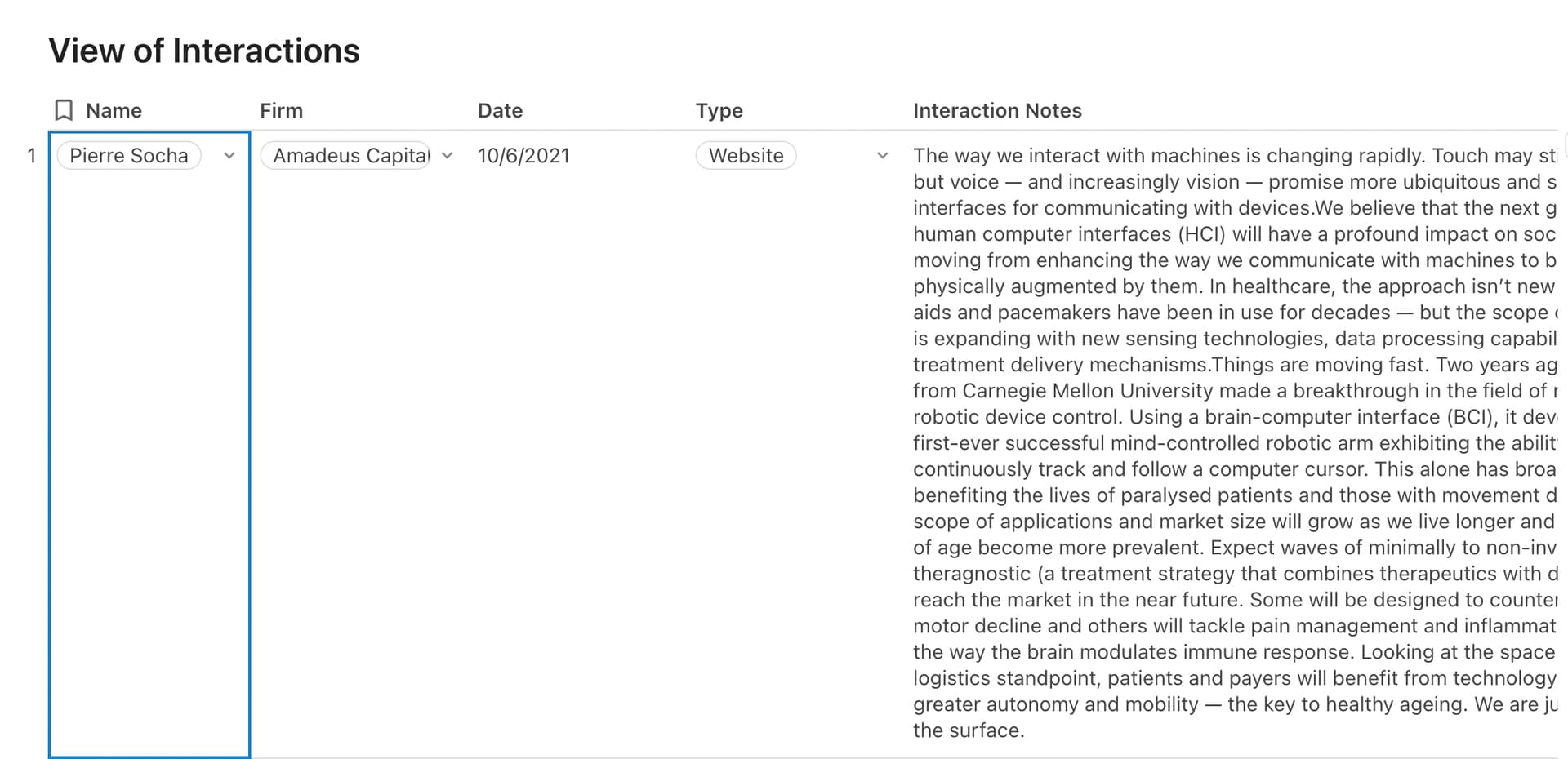

The table below was created by linking it to another table where the information is sorted through the “Name” column.
However, is there a way I can search for information by the firm name rather than person name? I want to create another table with the same information but this time i want the information sorted based on firm name.

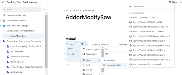

  3. If you want to be able to automatically search through the table, this is the way to do it:
Create a search filter into the table by going to the column you want to search, selecting Filter from the dropdown, and then select “Create Control” This will create a search box that will allow one to search that column. One can add as many search boxes as needed to a table.
