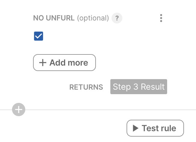

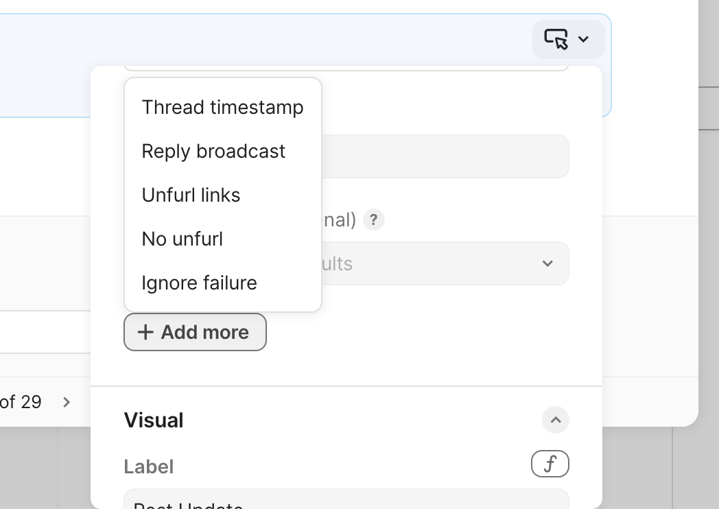

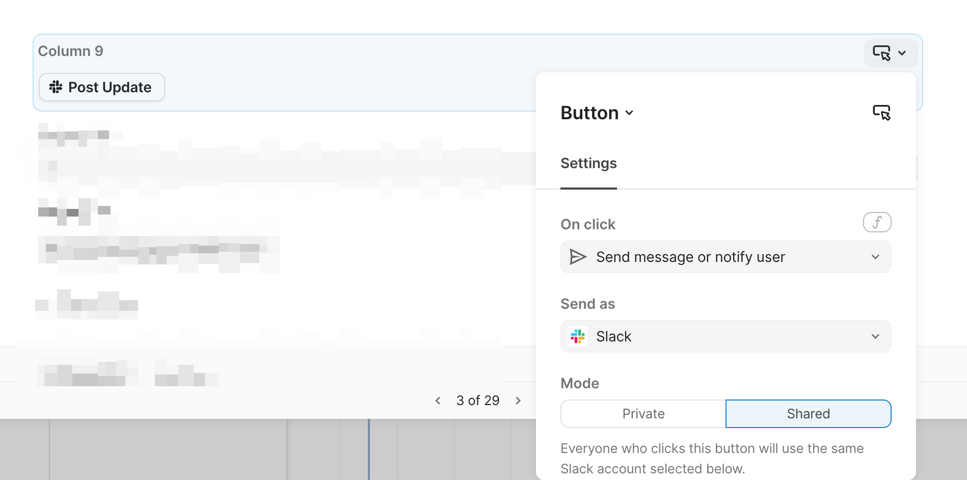

Is there some way we can add this option to the Send message or notify user button press interface?
Thank you
Never mind, I found it. I’m an idiot.
