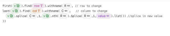

We can MODIFY a cell for row & col using the splice() formula as follows
The result is a new virtual table with the single cell at row & col changed to value
Note that this is NOT an action formula. So it does not need to be in a BUTTON or AUTOMATION.
We can manipulate virtual tables inside ordinary column formulas (or canvas formulas).
The resulting virtual table is updated immidiately without the need to click a button.

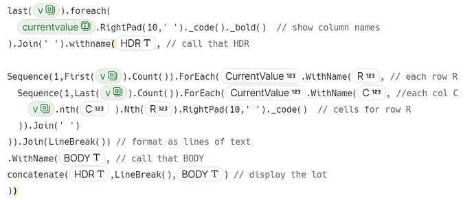

We can display the virtual table using this code…
Which looks like this;
