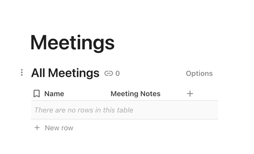

Here’s an example doc:
My question is this.

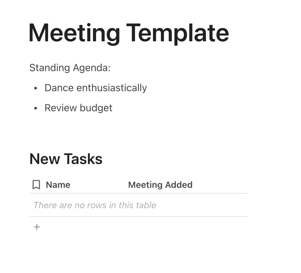

Given this Meeting Template page:
How can I create a new meeting:

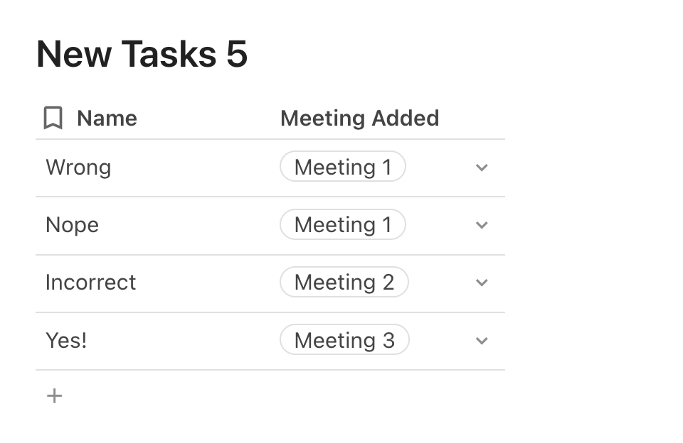

Such that in the canvas of the new row, the New Tasks table view only shows tasks relevant to the current meeting:

Just saw your response @Kelsey_Chan! Ok… is there an elegant way to do that you can share?
The hesitation I have with this approach is that it means I’ll have a row (maybe multiple if I have different versions) in my table that means something different from the other rows, it’s a template row, whereas all the other rows are meeting rows. I’ll have to remember to filter it out every time I do some lookup, “give me the average of all meeting feedbacks from the past 3 years… oh yeah, except the template rows.” I might know that, but will a user of a doc know? Likely, no.

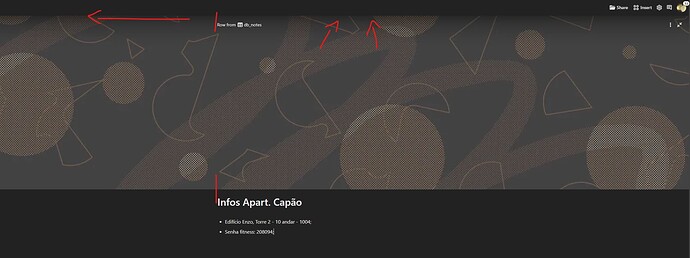

Hi @Kelsey_Chan! Although the full screen view of the row is pretty usable, it still lacks of some page functionalities. Some small aesthetic things the team could take a look is this black bar up top when you add a cover for the row and the weird aligment of the “row from …” link on the top:
@Guilherme_Salles Thanks for the feedback! I’ll pass it along to the team :raised_hands:
