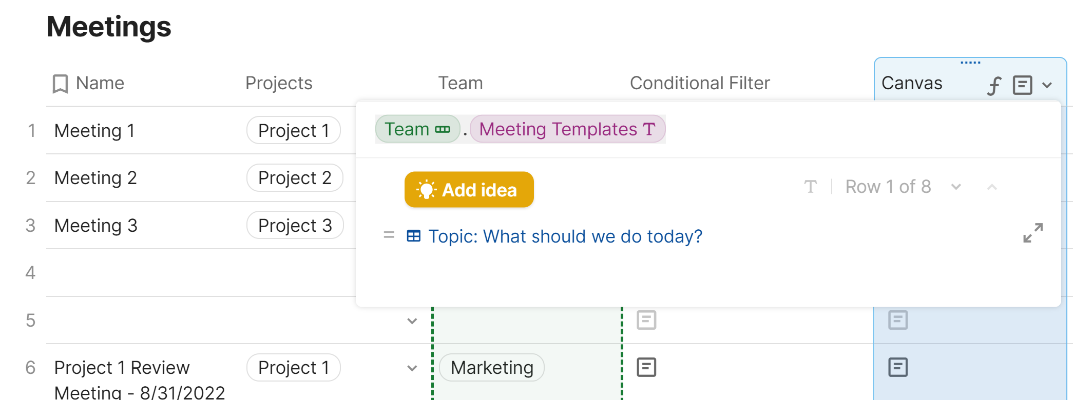

When adding a canvas column, you have the following available options.
Due to the highlighted items in the image above, many makers assumed this meant we could add If/Switch If formulas to conditionally add templates to a cell.
However, it seems that any formula just didn’t work even when they should…hence my frustration! :angry:

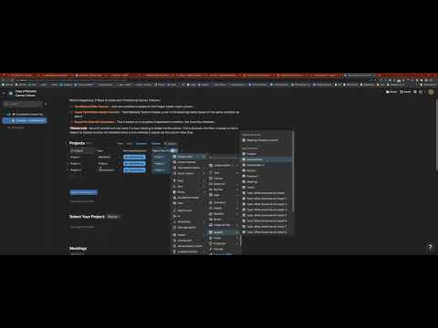

Below is a doc showing the fix I discovered, the fix Coda made (I think), and a reason I think some makers were having issues with canvas columns.

the SwitchIf can be replaced by chaining: thisRow.Team.[Meeting Templates] More dynamic, easier and faster.
and 2:
SwitchIf(Override=true, General.[Meeting Templates],"No Template Used"
can be written shorter as:
SwitchIf(Override, General.[Meeting Templates],"No Template Used"
Hope it helps, cheers, Christiaan

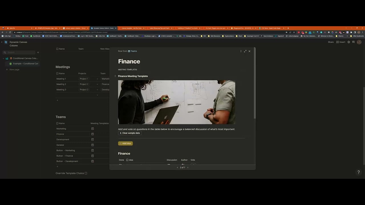

Please allow me to add my 2 cents: As you point out in your doc, in your template the tables are disconnected. Hence, any changes captured during a particular meeting will not be pushed back to the base table (which might be perfectly fine for certain use cases, of course).
For those use cases, however, where connected views are essential, I have thus built upon your approach and created a template that uses multiple templates, but keeps the tables connected.
Anyone interested can find it here

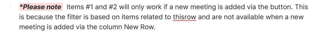

Hi, I know this is old, and also my brain is dead from trying to figure this stuff out but…I wanted to add a bit here. I didn’t notice @Nina_Ledid 's version until after using @Mike_Ray 's–thanks to both of you!! But also–Mike, you mentioned your first 2 methods only work if a meeting is added via the button…
