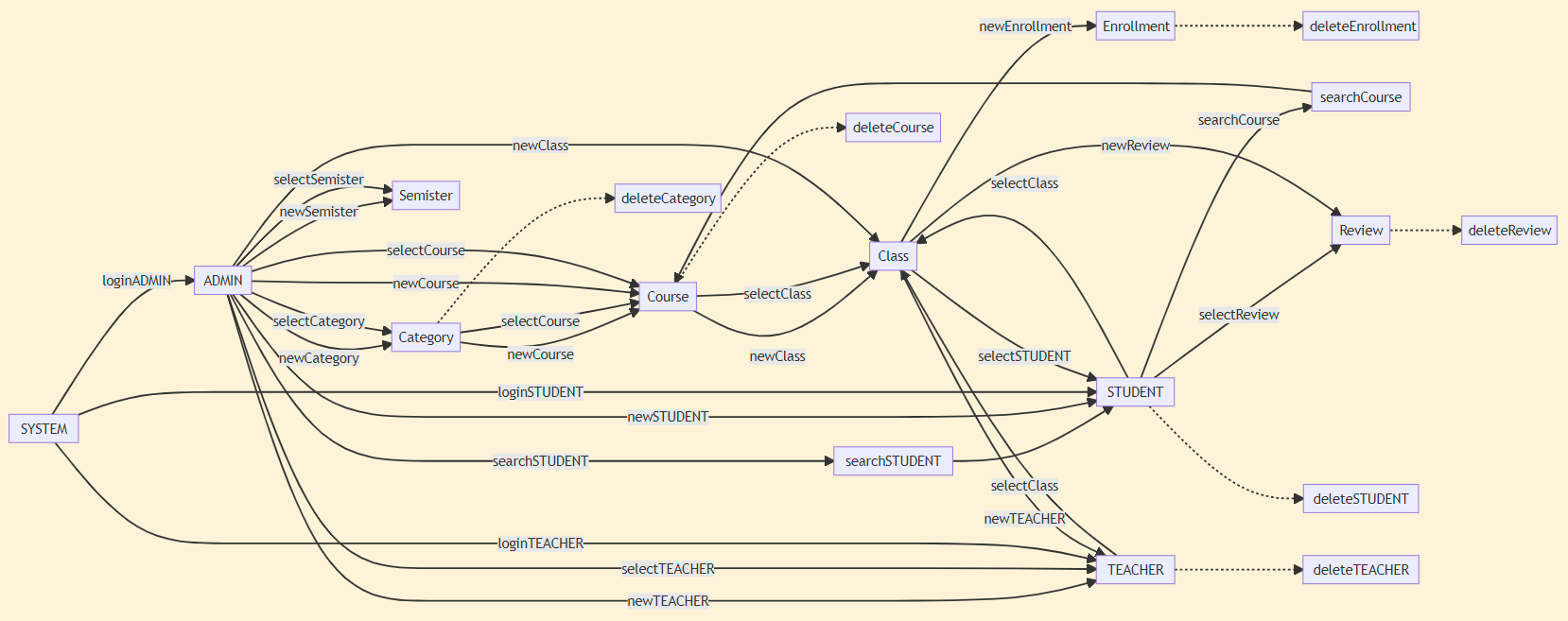

"Agile Architect" App Design Tool (Quick Demo)
A few weeks ago I gave a short demo of my AGILE ARCHITECT tool that helps makers to design and build complex workflows in a systematic way. The tool uses the KNOWLEDGE GRAPH methodology to define both the DATA and the BEHAVOUR dimensions of the Workflow. Here is a short video…
The tool helps the maker to look at the workflow as a set of Business Objects.
For each Business Object, it asks a series of simple questions like;
  • What other objects belong to this one? (Its Children or 1-to-many links)
  • What other objects does this one belong to? (Its Parents or many-to-one links)
  • Who can create, modify and delete this object?
  • and so forth…
This builds up ‘the Matrix’ - a table that describes the Workflow properties in detail.
From this Matrix the tool generates 3 diagrams;
The Object Model - showing how all the Objects are related to each other
The Workflow Diagram - showing all the execution paths through the Workflow
An EDR (Entity Relationship Diagram) showing the complete database
Then the tool uses Coda AI to build the actual Coda Tables.
The main purpose of this tool is to help Makers work with their ‘clients’ in an effecient and puposeful way. Ask these questions - gather these details - and present the client with the full solution.
Given these diagrams, a competent maker can quickly build out the full Workflow with all the User Interface layouts, and action buttons - to quickly deliver the version v1.0 workflow.
I need makers to help me figure out how to progress this project. What things are unclear and need improving. What other capabilities they might need, etc…
So I am asking community members here to PM me if they wish to participate in this project.
