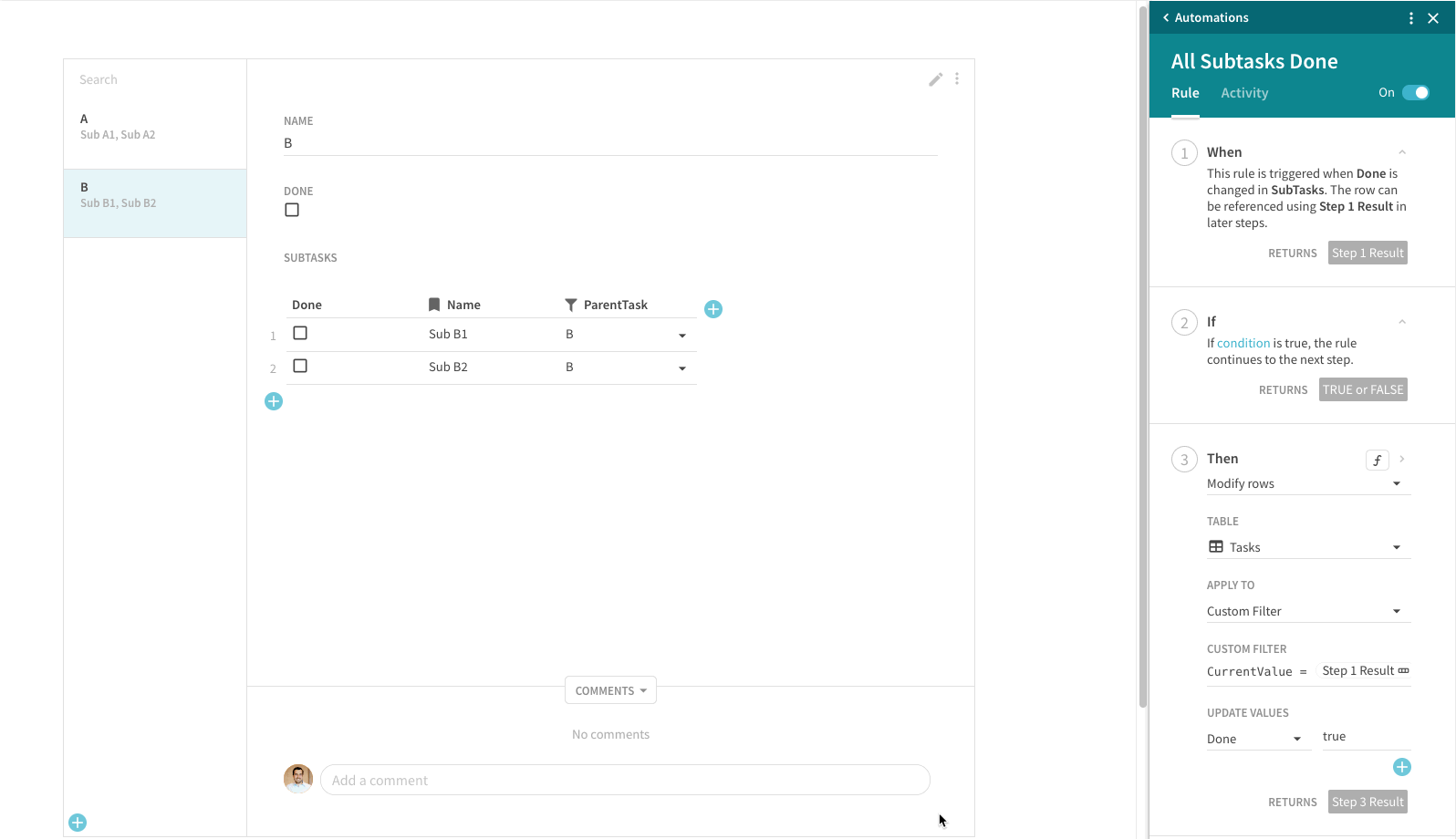

I thought I would share a simple example of how you can setup a document to have task’s with sub tasks and automatically mark a task done when all sub tasks are complete. If you want you can also add an automation to mark all subtasks complete if you mark the master task as done.
Marking parent task done when all sub tasks are done:
Formulas
If conditional to check if all tasks are complete:
Subtasks.Filter([Step 1 Result].ParentTask = ParentTask).Done.All(CurrentValue)
Custom Filter on Task table:
CurrentValue = [Step 1 Result].ParentTask
Marking all subtasks done when marking parent complete.
Formulas
Custom Filter on SubTasks table:
ParentTask = [Step 1 Result]
Note: This will currently not work on multiple levels of depth as we do not support triggering an automation using an automation.
