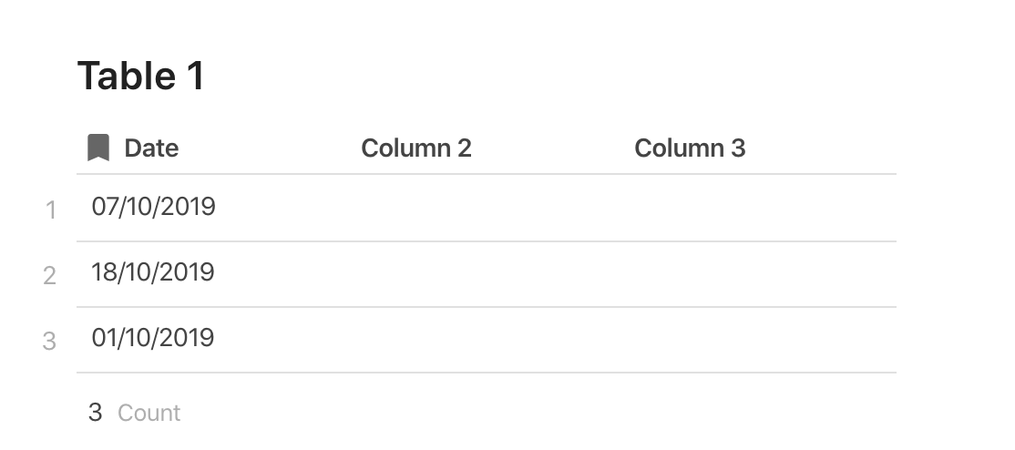

I have a simple table with a date column.
I would like an automation that does the following:
When? Every day at 9AM -> this is working obv
What trigger?
for each row
if date column < today ()
This is where the issue arrises. If I select my column, it gives me an array of dates. How do I test the whole array against Today()? If any of the array is lower than today, the automation should be triggered.
Thank you,
Sonny

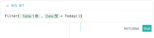

Is this what you were trying to do ? :blush:
I’ve tried this in a “Test table” Table 1 where 2 of the dates are <Today()
This is if the Date column is set as display. If it’s not the case, it returns this :
