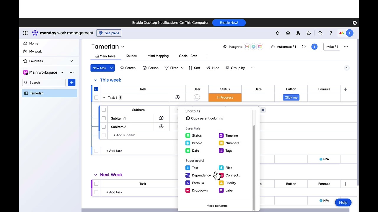

Thank you very much for the demo doc! Unfortunately, judging by what is presented in the doc, my concerns have been confirmed. Coda followed the path of least resistance and simply created subitems just like Notion did. That is, we will not have any independent columns here, and all subitems will be overloaded with the properties of the parent element, which will be inconvenient. In the video attached, there is an example of how I believe Coda could have implemented this. And the question of how this will look in other views and how convenient it will be also remains open.

Thank you, Piet, for bringing up that point. I’m fully aware of how properties work in the context of the subitems feature, and I understand that child columns operate independently. This is an expected functionality — after all, that’s the purpose of having subitems. However, I think there might be a slight misunderstanding. What I’m referring to is the ability to have an entirely different set of properties for subitems, without inheriting the columns from the parent item. I’d like to refer you to the video in my previous post, which illustrates how this could potentially be implemented.
This becomes especially important in complex projects with different task categories that require tracking various metrics, but still need to fit into a unified task tree. While it’s possible to combine all properties into one large table, it can quickly become unwieldy and hard to manage. When working on multiple projects with hundreds of sub-tasks of different configurations, the current subitems implementation could make task management quite challenging.
It could work like this:
Activating the feature would imply selecting a pre-prepared table to use for the child elements — something like ā€œMerge Table for Subitems.ā€ At the same time, we would still have the option to choose the same table, which would give us the traditional subitems setup similar to what’s presented in the beta. This way, we would achieve flexibility and full control over the project structure.
What’s being prepared for release seems like a lazy approach and an underdeveloped solution, which is very unlike Coda, a company that has always prioritized well-thought-out functionality.

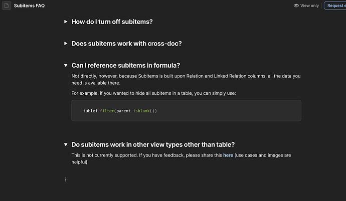

The subitems FAQ says subitems arent currently supported in other views
